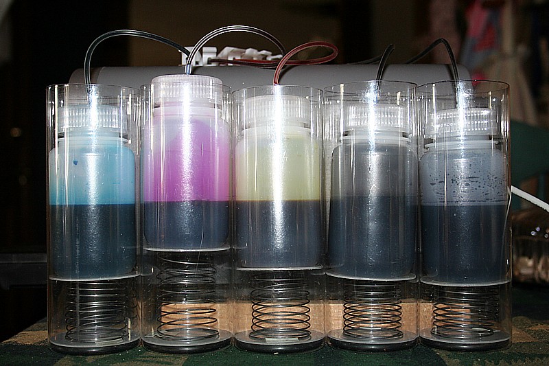

In operation, the print head sucks in the ink it needs. If it has to suck the ink upward against the force of gravity, a negative pressure will be formed in the tube that carries the ink. To establish a negative 1 inch water column pressure, the ink needs to be sucked upward 1 inch. This means that with a CIS and its tubing connecting to the external bottles, the surface level of the ink in the external bottles needs to be 1 inch below the print head ink entrance. If the surface level of the ink can be kept at 1 inch below the print head ink entrance elevation, the pressure will stay constant.
It has been suggested before that floating the CIS bottles somehow could help make a more constant operating pressure. What is shown here is a practical and simple method of "floating" the CIS bottles resulting in the constant negative pressure desired.
Note that the quantity of magenta ink is distinctly less than the others, but its surface level is the same as the others. The spring lifts the bottle by the correct amount as the ink is consumed.
Each bottle is supported by a coil spring in compression. The spring rate of the compression springs matches the ink weight rate of the bottles. The weight of one inch of ink in the bottle is matched by the force required to compress the spring one inch. The result is that the ink surface is kept at a constant elevation. Since the printer tolerates a spread of the negative pressure, great perfection is not required. If the spring rate accuracy is within 10%, operation will be fine.

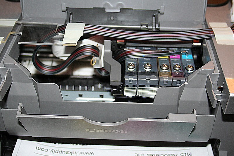

Here is a peek inside the printer. Please remember that this is experimental, so not a "finished" thing. Click on the photo to enlarge it and use your back arrow to return to this page.

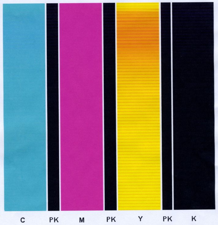

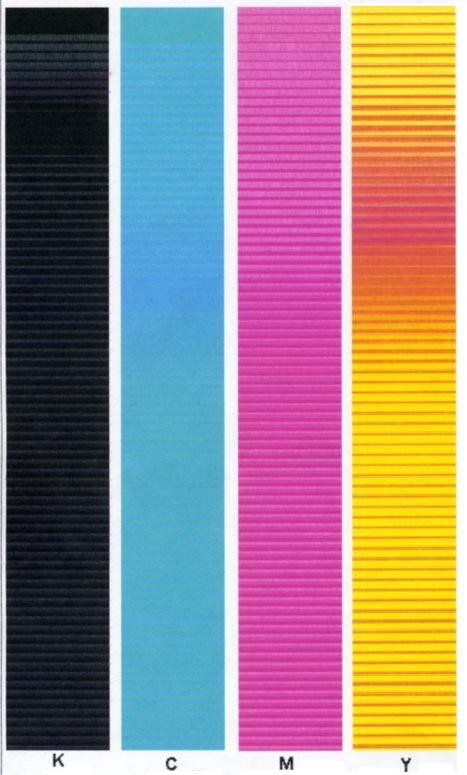

Here are two scans of purge prints done when the CIS ink level was too high. Has anyone else had printouts that might have looked like these or related problems while operating a CIS?
The stripes labelled PK are pigment black. I see some sites call this BK for short. The K stripe is dye black.
When the ink was lowered back to a level that was 0.6" or 1.0" below the cartridge bottom, the problem demonstrated here went away, but it took another page of purge printing before it cleared completely.
When I tried lifting one color at a time to the "too high" level, it seemed to me that the magenta was more prone to problems with this condition than the other colors. Perhaps the print head itself has some variation in the paths for magenta ink, and perhaps it only seems different to me.
Does an extra sensitivity to magenta seem like something you might have experienced also? I know that Websnail went through some pain with magenta.
SOME pains??... I went through hell and back with that bloody colour :)
Hadn't thought about the pathways but I guess that would make sense... Could just be the composition though...
