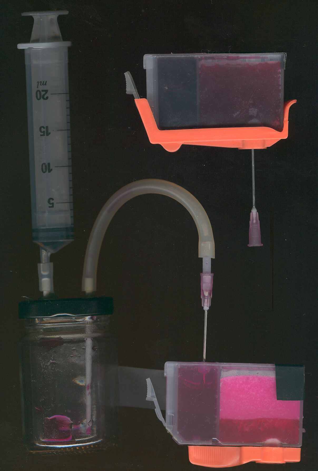

I think the refill system is like this:
IMHO it only saves the trouble of washing the syringe after refill.

Actually you can. I found this you tube video: http://www.youtube.com/watch?v=U7Qpsvw8QcM and being inspired by your nice drawing, I decided to give the method a try with compatible CLI-8 cartridges. No reason to use OEM cartridges for initial tests with a new and unknown system. So I quickly made this, click to enlarge:
I found out it is a vacuum fill system, much like ghwellsjr's freedom refill method, or in this case a hybrid of freedom refill and top filling. It works, and replacing the 20 ml syringe with a 50 ml syringe improves the method. You can also use one of octoinkjet's storage clips and insert a needle and do something more like a traditional freedom refill.
The method works, but the freedom method works better. The glass container adds unnecessary complexity and dead space to the system, and when more ink is used, more dead space is added. If you want to use the system as shown in the video, you will have to replace the sealing plastic ball with a silicone plug to pierce the needle through to make an airtight connection, or maybe a suitable adapter can be made.
In my opinion this system is no improvement over the freedom refill method or traditional German or top fill methods. I also think The Hat's PGI-9/29 refiller is simple and very elegant, needing no improvement, and I doubt that this system will bring any improvement, except maybe by looking very technical.
This system is not quite useless IMO, if you leave the vent and outlet open and pressurize the glass container with the syringe, it can be used as a cartridge flusher. But a freedom refill adapter allows you to flush a cartridge without removing the sealing ball, which I think is much better.
