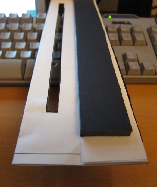

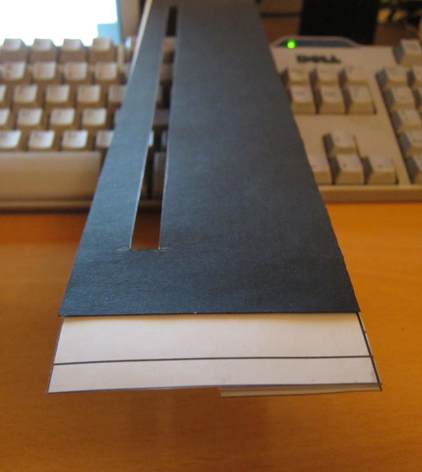

Now you should concentrate in reading: the consistency of reading it slowly and steadily is very important to obtain good profiles.
This seems to be more important than I thought!
So I modified your ruler: with a bar of "kapa" cardboard as a guide sticked on the top and a black paper on the bottom, cutted precisely to avoid false lighting. I left the white paper on top as it glides better than the black paper.
It's not to compare with emulators wooden carriage (see post 20) but imho effective: chartread is easier with less errors, it seems to improve also the reading of CM original targets, despite the much bigger patches!
And for the batch files: I tried to only chartread and colprof your 480target with the CAP480.bat - and it works! No wonder as the attributes of these two commands are the same in both batch files... (still having problems to keep "makeprofile.bat" running ... It seems to dislike my system)
