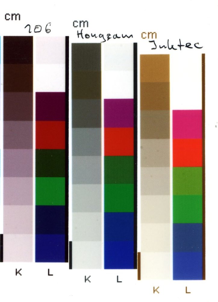

This scan shows how the color patches look after these 10 days - it's just 2 columns on the right of the complete patch sheet - left for the Epson 106 ink - for the Hongsam ink in the middle and the Inktec ink right - the column K contains a step sequence of gray patches , and the discoloration of the Inktec patches to brown is directly visible - this because one color is fading much faster than the other colors - the gray tones are mixed from CMY by the driver.

What's wrong with Inktec inks - you probably know the American analog color TV transmission mode - NTSC - never the same color - so you can enjoy different colors every week with those inks. But seriously - lots of prints are thrown away after a short while so color changes wouldn't matter. I have a bigger problem here that a potential buyer is not made aware of particular ink properties and he is not given a choice , and this not just by most 3rd party distributors but by the Canons and Epsons as well - they don't tell their users about the mediocre performance of some of their inks - Epson 664 or 102 or Canon GI-50/51 etc - as tested whereas HP is shipping a very good ink - HP31 or GT52 - with all of their tank printers. And worse - there is not much of a price difference between the good and the weak inks so the pricing does not help for orientation.

Am I interpreting correctly that the Hongsam performs best here?

The Hongsam L-column is slightly lighter than the Epson 106 L-column which gives a small benefit to the Epson 106 ink, but the Hongsam ink is pretty good indeed in comprison. And the top left patch - pure black is darker than the resp. black patch at the top of the Hongsam K-column. Inktec turned brown completely.
