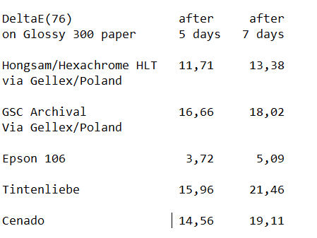

I'm closing this test with these results:
The Tintenliebe ink maintains its first place as the fastest fading ink in several tests so far, but the Cenado ink is pretty close - black turned into a light milk chocolade brown at this time. The GSC 'Archival' ink is disappointing, and the Hongsam HLT ink performs somewhat better than the other 3rd party inks in this test, but does not really reach the performance of the Epson 106 ink at all. This clearly shows the difficulty to buy a 3rd party ink by its fading performance - no reliable data are available but just supplier promises like 'UV resistance' or 'archival' or similar. It's up to the user to find the balance between pricing, assumed performance and availability.
The test ends here, all non-OEM inks of this and other recent tests are collected by color into larger bottles already and will be used up over time for short term prints - internet and such.

These are the profiles with Cenado - Hongsam and Epson 106 inks as the test started - they vary quite a lot in the darker ranges.
The profiles are created with a patch sheet with 96 patches, the i1Profiler software let me scan the patch sheets and can make a comparison of the patches before and after expsure and then calucates a deltaE per patch and takes an average of all those deviations. That is a first level indicator how those DeltaE's vary with the inks over time, but there are more effects hiding and covered up in these averages.
You can have different situations
- all patches vary by a similar amout
- or patches with one color - e.g. cyan - fade faster - deltaE's are larger - and are smaller for the other colors - the average may be the same as in the previous case
And does this make a visible difference - yes it does - when all patches lighten up with a similar speed the printed image gets lighter but the overall impression remains - there is no significant color cast or shift
or you have the case that the black ink fades much faster than cyan - gets even lighter than cyan - and turns chocolade brown which creates a kind of strange almost ugly look although the average DeltaE remains the same
and/or cyan is shifting much faster then the other colors which creates a very visible color cast in a printed image - and this is very much visible as well - although the deltaE still has the same value.
I have shown these effects in a test about a year ago that colors can shift with different speed - and adding more to the fun - this is not just an ink characteristic but depends as well on the paper you are using. You even can have opposite effects on different papers -one ink color fades faster than the other colors on one paper type and slower on another paper type. There is quite some fun when you start observing these effects. There is no way to put all this complex behaviour into just one rating number. These DeltaE numbers are a prelim indicator but do not tell the complete performance.
Considering all this I can judge the Hongsam HLF ink performing quite well in my test - better than quite a lot of other inks I have seen but the inks nevertheless do not come close to the performance of the Epson inks.

Yes, the gamuts vary quite a lot - these are pretty different inks overall.
When I go into the detailed numbers you see this
- the Hongsam black just shifts by a deltaE of 4,1 in a week, that's very good - better than the average, other inks like Inktec run higher than average with the black, that's an ink in which black turns to chocolade brown very quickly, and that looks ugly.
When you look to the primary ink colors CMY you see this :
- Cyan tpyically fades the most - 17,11 for the Hongsam ink
- Magenta fades by 11,1
- Yellow by 2,7
- The ratio Cyan/Magenta is 1,5 , that is barely visible as a shift to red/brown after a while, I have seen ratios up to 4,0 with some inks , Cyan faded much faster than Magenta and prints got a red shift/color cast pretty soon, and when you combine that with a weak black you have the worst combination of bad properties.
And mixed colors with a higher ink density fade faster as well, specifically those in the lower , darker gamut range, there are just more color molecules which are affected by UV/ozone, so a dark brown can show a value of 25.
You see that an overall average is a good indicator to separate different groups of inks - a DeltaE of 3,9 is def. better than a DeltaE of 12 or 20 , but if you have numbers like 7,9 and 9,1 it is not that simple anymore, and a look to the individual inks - black and the ratio of Cyan/Magenta gives you much better information. You can go into details more and more but I don't see much of a benefit there, I'm not going to the level of Aardenburg Imaging doing spreadsheets and graphs etc.
https://www.aardenburg-imaging.com/ under the tab 'Research - Light Fade Test Results'
You need to get registered, but that's free.
