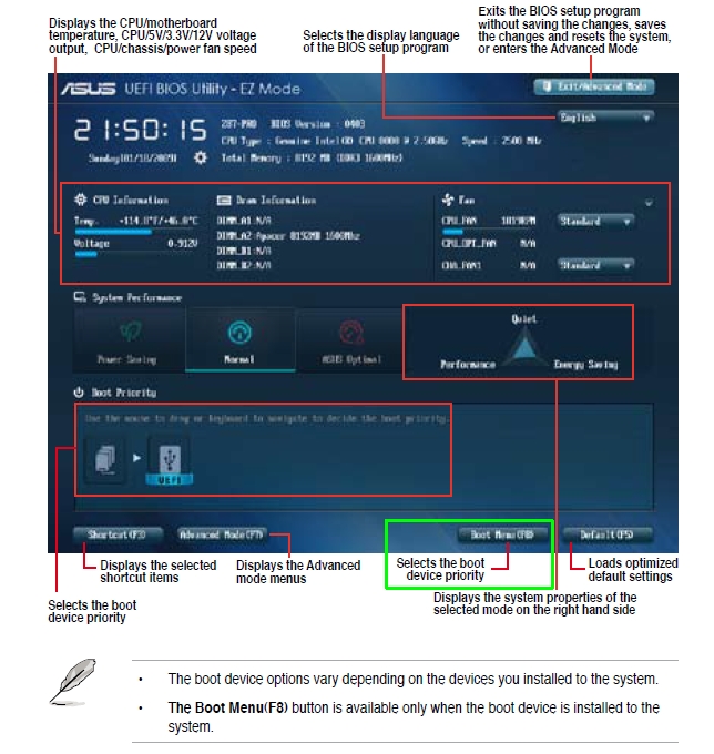

page 3-3 has boot device priority. That should fix the issue about HD vs. SSD booting. If the migration was not done properly and the boot device priority was not selected, then the issues described will surface.
It was the screen on 3-3 and the Advanced Mode BIOS set up screens, that I was using initially and found I could not change the BIOS Priority. It seems that this only shows you what you have set up by your choice of SATA connectors.
The selection of connectors occurs at page 1-38 some days earlier!

So the item marked in green doesn't allow you to alter boot priority? Will pressing F8 during POST allow you to choose boot from an optical drive?
You are good at your graphics Peter.:)
If you click on the green area you get a window showing all the various drives, in a column. But if you click on, say the SSD, or any other, it dumps you immediately, completely out of the Utility, starts Windows and does not change a thing. I say any other, but I did not try the USB, that might have worked as it was illustrated in the BIOS Priorities.
I have just re-booted into the BIOS utility and although the screen does not represent an appropriate image, if you hover the pointer over the device image, the description has changed and the first one is now the SSD. This is because I changed the SSD SATA 6 connector to the motherboard SATA number one socket.
