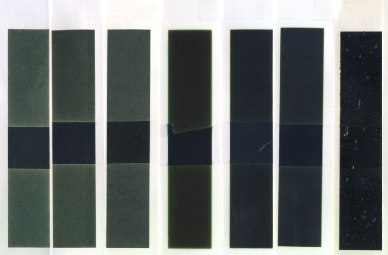

I did a fading test about 2 months ago - same ink EV6 on different papers in posting #151, and I redid this test with more sun, other ink , this time a 6 color dye ink Coloration ED by farbenwerk.com, and printed my test patterns on the same range of papers. This is the result after 15 days for the black patch fields, taped together for scanning. I placed a piece of clear scotch tape across the middle of the patch fields at the beginning of the test to see how much such a plastic foil, like lamination can do.
these are the papers in sequence from left to right
1-LS (Logic Seek)180 CC, 2-Labelheaven 180 CC, 3-Tecco Duo matt, 4-Sihl glossy RC, 5-Tecco Photo Glossy PG250 RC, 6-HP Premium Glossy Photo RC, 7-an unkown swellable paper (with some raindrops)
The differences are clearly visible and pretty great , the cast coated cheepies 1 and 2 are the quickest with fading, 3 as a matte paper does not perform better, Sihl #4 performs better but not as good as the premíum papers 5 and 6, the darkest and best overall is #7 but its surface is uneven and not very pleasant to look at.
The black Coloration ink fades to gray, pretty much different to the Precisioncolors EV6 black ink which I used earlier fades to chocolade brown , and its funny to see that the Sihl paper # 4 fades to brown regardless - the paper type does not just influence the fading speed but as well the interim color to a degree.
The scotch tape effect becomes pretty much visible as well, it has a visible and great impact onto the fading, it's probably both a protection filtering UV and as well against gaseous agents like ozone. I would expect a similar effect by lamination or spray coating, or probably glass to some degree.
The targets are placed outside, day and night, with changing temperature and humidity, and protected against rain - mostly.
I'll continue the test for a while and then read the gray levels and brightness increase by paper type, as well for the cyan ink. The cyan patches perform quite similar, they don't give any more information at this time.
I can confirm with this test that the paper type has significant impact onto the overall fading performance of an ink/paper combination, the Tecco PG 250 is about 10x more expensive as the Labelheaven paper which should help making a decision. The Tecco PG250 is specifically offered for Drylab/Surelab printers and available in a range of roll and sheet paper formats.

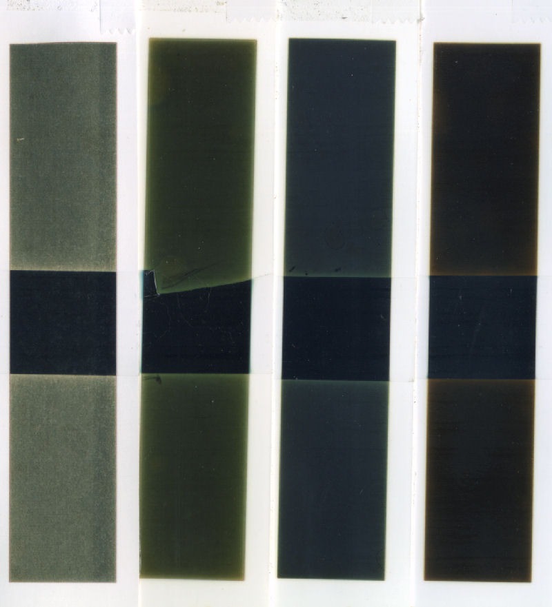

Let me give you an update how different papers fade - with the same ink set, as above and 5 days later
The papers are from left to right - Labelheaven180 castcoated is the cheapest - Sihl/Aldi Glossy turning brown - HP Premium Photo Plus Glossy with the black changing more into a blueish gray - and the darkest at the right side is a Tecco PG250 starting to change as well to dark brown. The differences in UV stability are significant, and the strong protection by the Scotch tape across the middle of the patches is as well visible, it would probably be very similar to lamination if such additional protection is necessary. I don't have any UV protection spray available nor a gloss optimizer for comparison, that would be something for a separate test.
I think this test shows very clearly that the choice of paper has a high impact onto the fading performance of inks and printouts with these inks.
