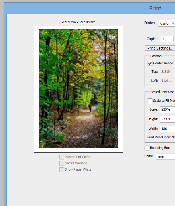

Hi guys, I am using a Canon MG2950 printer.
The problem I have (and have had for a long time) is that when I print a photo (no matter the size of paper, or what sort of camera I use) I always get one border which is about three times the width of the others, it is driving me crazy as I am at the point where I need some good prints.

@laon Robertson, regardless of which printer you are using, a print doesn’t go off centre by itself or made to do so by the printer.
We should look at the Application your using for that, because that’s where your problem lies, in it not delivering the correct image cordinence to the printer, some final settings must be incorrect.
You wouldn’t be using a Mac by any Chance ?
The sample supplied was displayed in PhotoShop.
@Roy Sletcher, Please excuse me using your POW for this demonstration...

@Iaon Robertson could you upload a scan or photo of one of the not centred prints?
I tried printing some test images on 4" x 6" photo paper using Canon the two cartridge MP270 and the five cartridge MP800. Both printers have wider border at the bottom when printed in portrait orientation.
Here is a preview from Windows using the MP270:
Notice that the bottom border at the right is wider than the top border at the left.
Here is a scan of the print It is a bit difficult to see but the wider bottom border matches the preview perfectly. I think the problem might be caused by differences in aspect ratio for the image and the photo paper. More Canon printers do this.

Thanks for that, I am ripping my hair out now going through various settings without luck. I am at the moment trying to print off some 4"x6" landscape but have three borders of 5mm and the right hand border is 15mm. I have tried borderless but does not work either. Thanks for the advice, I will as they say soldier on.
