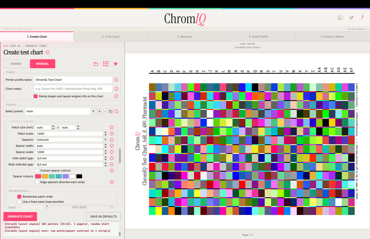

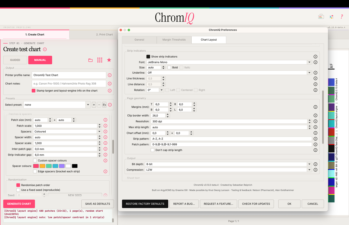

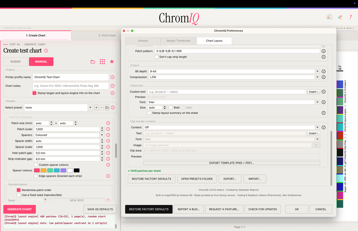

What kind of options would you need to create better chart layouts?
The arrangement of the options is not yet optimal I think. The placholder token need some work to show better instrument names I think. Everything has to be proved working. Some thing might need to be added. Some maybe are too much. But maybe it is a good starting point. This completely replaces printtarg (although it is based on its code). So I don't have to edit the tiff files after they are created but give them the desired layout at creation time. Also this makes it easier to calculate the amount of patches fitting a single page with the chosen settings. For original printtarg I had to run printtarg for various combinations of instruments, paper sizes and additional options and create a database out of those. If you chose a combination of options that had not been covered by this that process was done at creation time - it ran targen plus printtarg around 10 times in a row until it found a match. Should be faster here.
BUT: Very beta...

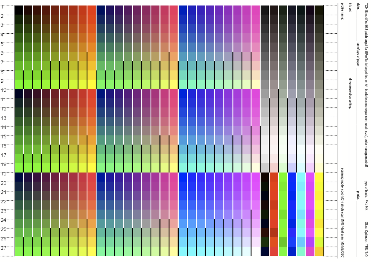

Edit: based on my TC9.18 target that can only be aligned on the right side but can not be clamped for the first 3 rows:
It has 27 rows of 34 patches, but since we want the target to be clamped the first 3 rows must be removed and we get 24x34=816 maximum patch count for ergonomical scanning:
This is the practical maximum amount of patches you can squeeze together: 24 rows of 34 patches, but to be safe I would keep the maximum to 24x32 patches= 768
