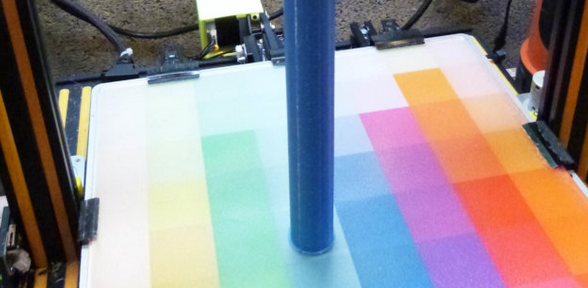

I got around the bow in the middle of my hot-bed by using an aluminium plate point 5 of a mm thick and 10 cm square under the glass and held down tightly with eight paper clamps, it seems to have evened the problem out and I’ve had little or no problems to speak of since..
