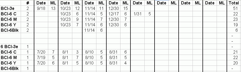

Can someone track the ink between refills?!?!?!?! Obviously you don't know how anally analytical I am! ;)
Here is a screen shot of my Excel spreadsheet where I was tracking my ink usage... well I WAS until I realized that I had too much time on my hands!
You'll see that there are two "sets" of records for two sets of cartridges. Also keep in mind that I almost always top off my carts when I see there is about 1/8 inch to 1/4 inch ink left in the reservoir portion of the cartridge. An interesting note, every time I open up the cartridge to refill this remaining ink always gets pulled into the cartridge.... does this happen to anyone else when they refill / top off a cartridge?
