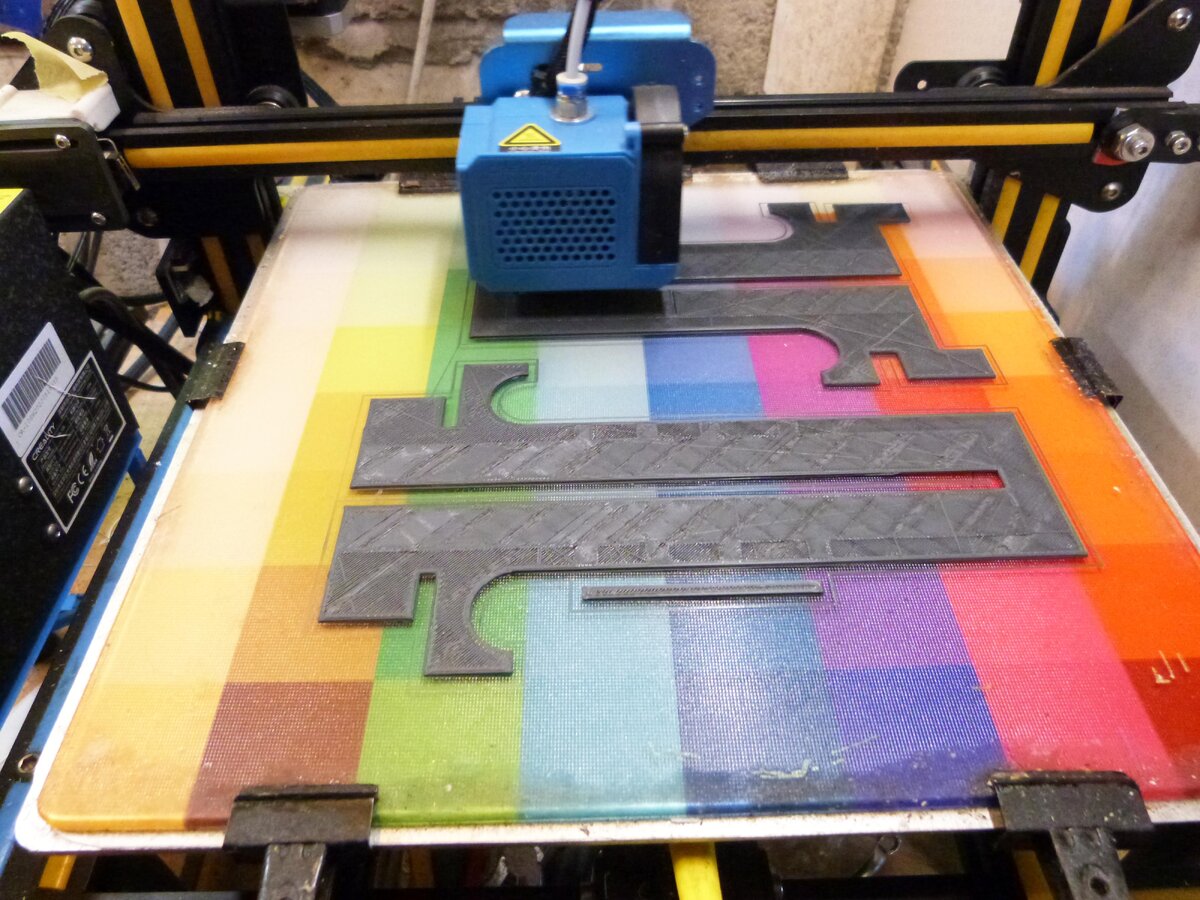

I can do a test with the new slightly elevated jig (I am now using a paper/wood jig, so practically flat) and see if there is a difference by scanning with both my older paper/wood jig.

I'm in the process of printing your two STL files..
Send me a PM if you want details about the assembly, but it's quite straightforward. I used cyanoacrylate and four steel rods of 2mm to join the two parts. Replacing the rods with filament probably would be OK as well.
16,231
9,161
It’s not me that will need assembly instructions, I won’t be using it, I intend sending it to @pharmacist..
But as you say putting it together is straightforward..
P.S. the finished item looks pretty good.. Thank you..:thumbsup
