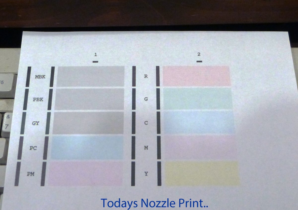

She has not been used since the 19th February last, and when powered on, it started with the Ink Quality Maintenance routine (Shaking).. Next it did the customary cleaning cycle, and I followed that up with a Nozzle check.

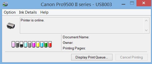

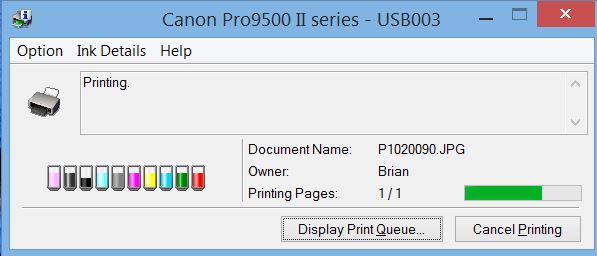

Here are the ink levels before and after printing, (Spot the difference !) I can't..!
View attachment 12692 snapped with the camera.. To lasy to scan.. View attachment 12695
View attachment 12690View attachment 12691
I suppose the printer was at the maximum purge volume, a proof indeed it doesn't make much sense to try to time it. Either you print with it or you shut it down.
Good to know too it wasn't clogged after 6 months.
