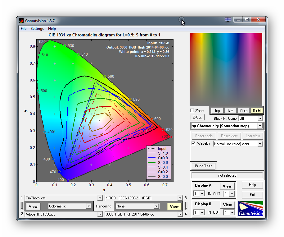

You can do it in Gamutvision like this (if it helps).
Yes, that seems an interesting approach, these show all three colour spaces against the 9000 II using PC ink and a microporous luster paper profile. Surprisingly similar to your sRGB in the first one.
Canon 9000 II sRGB gamut.png Canon 9000 II AdobeRGB 1998 gamut.png Canon 9000 II ProPhoto gamut.png
I think it clearly shows the 9000 II plus PC ink is better than I thought. One might even say that printing in ProPhoto might be beneficial!!! :)
I am surprised, can you add the Epson 3880 Adobe and ProPhoto gamut images to make up your set?
