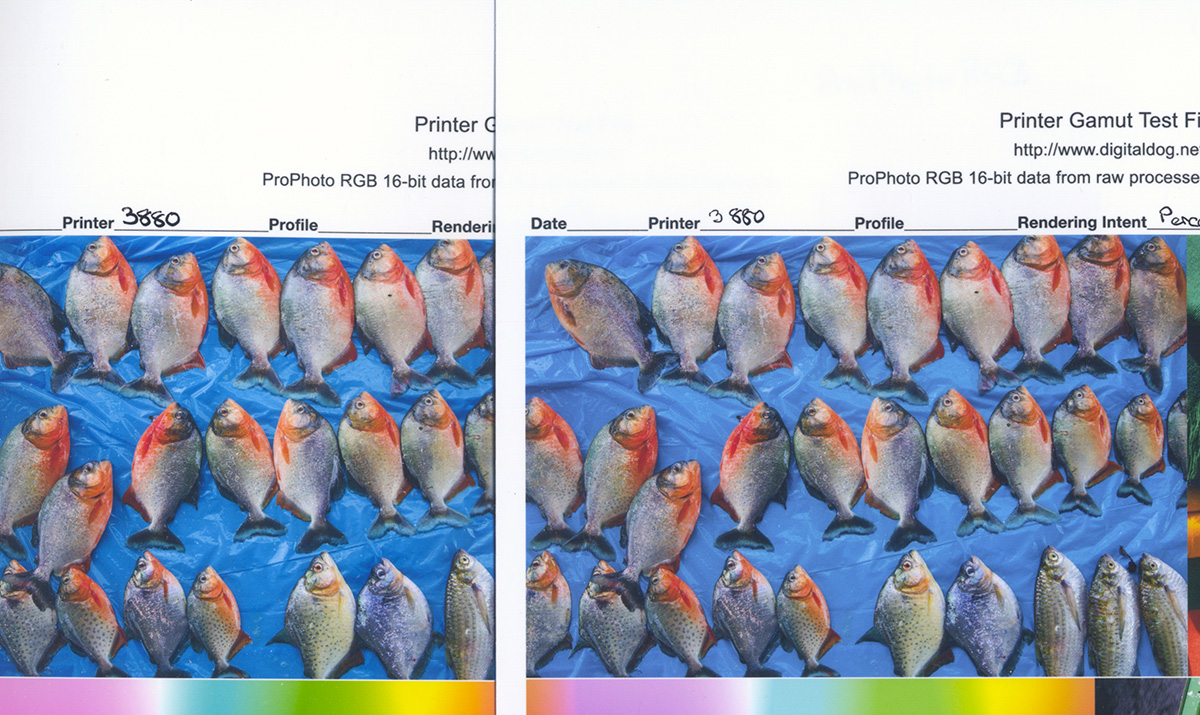

I'm surprised that the 9000II is so bad. Virtually every (valid ) inkjet profile that I have generated over the years has exceeded sRGB in the green/cyan, and very often in the yellow/red too; and that even includes a lot of profiles for printable CD's, which are not the best media available!
AS for the comparison of the images in the video, I think you need to do the test yourself. I agree that in the video the background of the fishes appears to have more detail in the sRGB image. I don't know why this is, but I suspect is to do with the way the composite image is converted to sRGB. In my tests the reverse is the case. Here's a scan of two prints from my 3880. The LH one is ProPhotoRGB and the RH is sRGB. That's what I see, but I suggest you try it yourself on your 9000II. You may be surprised.

The image I included in post #10 was just a scan of two prints I made following the method described by Digital Dog. So, the prints were made from the two different colour spaces. The scanned image is actually in sRGB, so the image I posted is a fair representation of what I can see on the two prints. Your monitor should look much the same as mine so you should see better gradation and more contrast in the blue background on the ProPhoRGB print.

What I find interesting is that the colours that are lost in using sRGB are not at all extreme and you wouldn't normally consider them to be out of gamut. But, the camera can record them, and the printer can print them, so why throw them away?
