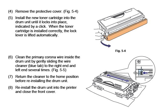

When you switch to compatible toner it has a tendency to do that, and I mentioned the Corona wire because if it’s dirty, that can cause the same issues your having, it’s uses a manual cleaning tab.. No instructions needed..
I have a 20 year old Samsung printer myself and it never has any issues because I only use OEM toner..
Here is a Pic of a Brother print toner cartridge, it shows where to look for the location of the Tab to clean your Corona wire, I hope it helps because the alternative is a replacement drum and cartridge..
I know, but I can't see the corona wire in this particular toner/drum unit without disassembling.
Okay, doesn't help me right now though.
Looks very different on a ML-2850D toner/drum unit unfortunately. I'll probably try disassembling the older of both cartridges and see if I can spot the corona wire anywhere.
