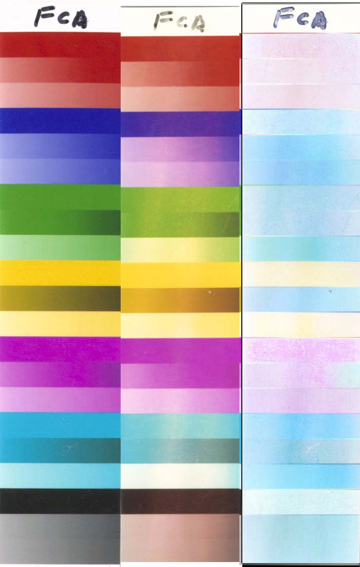

By way of a "teaser", here is the result of a 7 day light (UV) fading test on a Fuji Crystal Archive sample (rated at 60 years by Wilhelm). The left 1/3 is the original (unfaded) image, the middle 1/3 is the same image after 7 days in our light test, and the right 1/3 is the result of a Photoshop "Inverted Difference" between the two showing the colors that have been "lost" due to fading. Note that this sample faded predominantly in the cyan's. There is also some fading in the yellows, and very little fading in the magentas - almost exactly the opposite of what is being seen for inkjet inks. Note the light cyan gradient (the 4th bar up from the bottom) - it has almost completely faded away. Also note the red shift on the gray gradients on the bottom - indicating what happened to B&W in this test. The overall print density hasn't faded that badly, but without cyan the colors have shifted so that the print is unacceptable.
Our light/UV test method is simple, inexpensive and easily replicated by anyone at home. The downside is that our test is not calibrated to an "absolute" scale (years), but depends on a "relative" scale using comparisons between samples with an accepted lifetime and our test samples. Because of this, we need these additional samples for which there are accepted longevity values. If you have access to a printer with the reference inksets/papers, this is your opportunity to give something back to the forum. We also need samples of the other two major bulk inks (MIS and IS) to round out our initial tests (we already have Formulabs and WeInk BCI-7 samples). If you refill with either of these bulk inks, this is your opportunity to get information on their permanence for very little effort.
