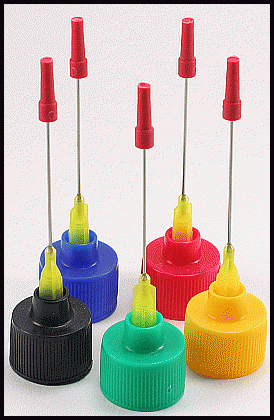

Binkie: You are missing the boat if you dont get the squeeze bottles and scabbards from Octoinkjet. Martin will sell you SquEasyFill bottles, either 100 ml or 250 ml size, complete with blunt needles and scabbards and appropriately color coded screw on caps. See the different sets here:
http://www.octoink.co.uk/categories/Refill-Tools%2fKits/SquEasyFill-Kits/
Or you can make up your own custom kits using components here:
http://www.octoink.co.uk/categories/Refill-Tools%2fKits/SquEasyFill-Custom-Kits/
You will need 2" needles for German Durchstich refill method.
Im located in the U.S. and shipping was $3 for 5 bottle set. Believe I also ordered extra needles with this shipment. Shipping took about 8 days from the U.K. Might add also that his web site has automatic currency conversion, so you will see pricing
in U.S. dollars. Very convenient detail I think. Here is a photo of my SquEasyFill bottles:
http://www.nifty-stuff.com/forum/uploads/4795_img_2203a.png
And here is a photo of the color coded caps with needles and scabbards:
http://www.nifty-stuff.com/forum/uploads/4795_img_2195.png

my $.02, since i started this thread. i have lots of experience in using both syringes and squeeze bottles. squeeze bottles are so much easier to refill, takes less time, almost at the point where i do not need gloves to refill. like most things in life, squeeze bottles takes a bit of practice, but after one or two times you'll be a pro. i have even used squeeze bottles to draw out ink from the sponge side or chamber side when needed.
i do refill over a flat container(see pics in post #1) in the event that there is a leak from the cartridge or bottle, but so far after a year or so, have been none.

Got my SquEasyFill 100ml kit -x6 [Canon] and 6 extra needles from OctoInjet yesterday. Filled the bottles this morning and refilled two cartridges with the German method. What a joy! It was much quicker, less messy, and easier than with syringes. The needles are the perfect length (2 inches) for the German method and are thinner than those on my syringes making going through the sponge easier.
The cost was reasonable, less than twenty bucks, including air mail postage from England. Service was great with emails sent letting me know what was happening. I received the goods, undamaged, in about a week.
I want to thank those who encouraged me to get the SquEasyFill kit and encourage others to do the same. You will not be disappointed.
