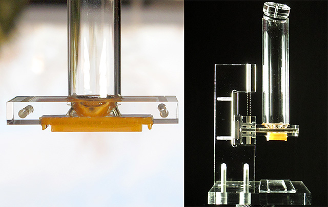

The left part in the picture shows plexiglass and a modified cap for PGI-9 cartridges glued
together with a cyanoacrylate that is used with a primer to stick to "hard-to-glue" materials.
The plastic stuff in the cap is unkown, no markings of what type it is. I tested a few other
glues on small pieces first but they all were easy to pull apart.
A link to a list of abbreviations used for plastic parts, often printed on the part.
Finding a glue is easier if you know what the parts are made of.
http://www.matweb.com/reference/abbreviations.aspx
[Click to enlarge]
The right part of the picture is the "filling station" with the removable tank/gasket.
Some glued parts use UV-curing cyanoacrylate, it's a dream to use compared to the one above.
You have unlimited time to do adjustments and remove excess glue. Put it in sunlight or under
a UV-lamp and it sets in seconds.
The key part is a linear rail guide that gives a parallell up-down movement of the tank/gasket.
The rest is just mechanical support. Sorry, I could not resist polishing the parts. Sometimes
I bring hardware to a local photo club to get the discussions going, you get points for "bling-factor".

I'm impressed. Your design certainly has the "bling-factor" :thumbsup
16,075
9,038
Your refill gadget looks the business and is certainly eye catching but I am curious as to how well it works,
you havent mentioned using it for real yet. (Less Bling, more dirt)
I dont really care if my refiller looks like the back end of a bus and it probably does,
just so long as it works and wont break the first time I use it,
Ive had a lot of colourful failures already and more to come I suspect..
