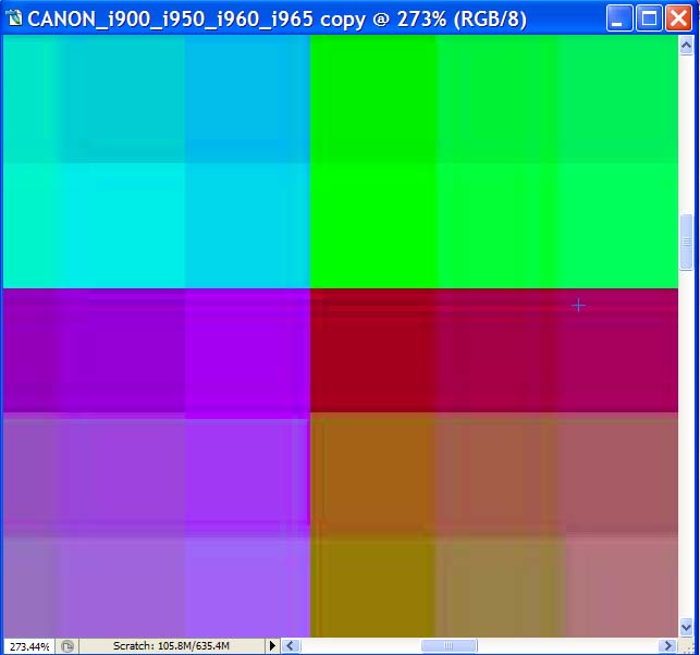

A few days of vacation later, let see where were we... Yes the monitor was calibrated with Spyder2 Pro. My print of the above Color Test file with no color management show some obvious problems
I found the forum instructions for uploading images but as this is the first time, I'm not entirely sure how to get the split channel images side by side.
If this workes the CMYK Cyan chanel is on the left and Magenta chanel is on the right. I am going to include the calibration charts as well. No profiling on the left, profiled on the right
There are some obvious differences from the original below
The differences from original to uncorrected print are not surprizing since this is the input to the profiling software. The profiled output of that same file is a little depressing, one expect a match. The top bar of your color test image are obviously over saturated (RGB image) but the grayscale progression on the split chanel images seems OK to me.
Lastly, I am including the Test Image from Colorvision. This is with profiling turned on and it actually looks good compared to the same file with OEM ink (sorry I don't have that image with me at present).

I split the image that you posted into C/M/Y/K, and the PM/Magenta and PC/Cyan transitions both look good (I got the same images as you posted for the cyan and magenta channels, but I also wanted to look at the yellow and black channels). The cyan channel looked close to the cyan channel in the original image that you printed, but the yellow and magenta were both about 10-20% weak. This can also be seen in the black gradient at the bottom of your color image, where there is a blue color cast (a typical set of R/G/B values in this area is 155/162/174). This is not a problem, as the profile is designed to correct such color imbalances.
BTW, When I want the images to appear side-by-side in a post I combine them into a single image and scale it down to 600 pixels for the total image width.
I assume that the last target image that you posted was the original target image that you printed. This is a blow-up of a section of the image that shows severe jpeg artifacts. Was this the image that you printed, or a compressed version that has a reduced file size for posting purposes? If this was the image that you printed, the colors on many of the swatches would be corrupted.

I forgot to mention one other important point. Only one of the images that you posted had an embedded profile. Without an embedded profile, there is no information telling how the color numbers are to be interpreted. This is similar to the crash of the space probe caused by one team working in meters while the other team worked in feet. An embedded profile defines what the color numbers mean compared to real world colors - without a profile, the color values are just numbers. This may be involved in the problem that you mentioned where your daughter's prints were oversaturated in magenta.
As a demonstration of what can happen, I loaded your last image as "sRGB" and also as "aRGB". I cropped them down to just the picture of the girl on the bottom left corner and included the color histograms for reference. These two images are included below. It is clear that the flesh tones on the two profiles are different. You will have to carefully compare the histograms to see the differences, but the red is clearly different in the bulge about 70% toward the right, and the green and blue are different at the left side. These differences are most easily seen on the tri-color histogram at the top. The fact that the differences occur in different places for different colors also demonstrates that the sRGB and aRGB profiles are not simple linear expansions/contractions of each other that can be corrected by an "intensity" adjustment on the printer driver.

This is going to be an adventure, let me start with the easy issues. The last PrintFix calibration target that I included in post #16 is the unprinted original from ColorVision (but as you pointed out, it is a compressed jpg version rather than the supplied .tif file), it seemed useful to include a "standard" for post-profile comparison of the printed output.
The soft-proof worked as expected when at home where the printer lives. If from Proof Setup>Custom you try to "load" a profile (because the appropriate .ICC wasn't on my laptop) the default file type is .PSF but that is now a non-issue.
The images that were scanned in did not have an embedded profile because I hadn't told the SilverFast AI software that drives the scanner to embed one. So thank you, I need to add the profile used for printing to the available list for the scanner.
The camera embedds sRGB.
CFriends made such a point of saying their inks matched OEM colors that I did take the easy route and refilled the Canon carts. I thought if they were close and I had the ability to adjust the profile through the transition that it would all work out....I really liked the blue plugs. That brings me to what I thought was the really striking difference between the Color Test image that you posted in #15 and my printed output. Although the transitions are OK the actual Cyan top bar of the original (RGB 1/255/253) is not even close to the same region of the printed (RGB 24/103/182) and Magenta original (RGB 255/0/255) vs 196/61/102. It does point out that I need to re-profile the scanner with the printed IT8 target from Monaco because the saturated blue is not black as it appears, but the Cyan and Magenta are really no where close to your original.
So...how can the profile be so far off? How does one begin to address the problem?
