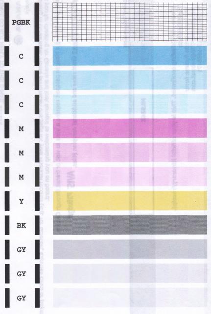

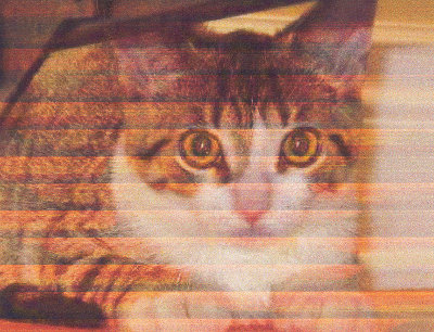

...negative, as in, they don't indicate there's a problem. I printed from and it's like some of the nozzles aren't firing sometimes. Then I printed a nozzle check and if you'll ignore the junk on the B-side of that paper that I couldn't remove from the scan, you'll see it came out beautifully. I tried printing the image a couple more times, and it was better, but far from perfect.
So why does my kitteh look so awful but a stupid test pattern came out perfectly?
I also did an automatic head alignment, but that shouldn't have made a difference, should it?

The red-orange appearance of what should be grey tones indicates that the complementary colour is missing. The complementary colour of red-orange is cyan, so this indicates an ink flow problem with cyan. This could be caused by the cyan cartridge, or the fine ink channels for cyan in the upper black plastic part of the print head could be clogged. Hopefully it is a cartridge problem. I suggest to try another cyan cartridge, best but expensive is a new Canon OEM cartridge for the testing.
The reason the problem doesn't show in the nozzle check is that nozzle checks use very little ink compared to photo printing, so the cartridge and the ink channels can deliver enough ink for a perfect nozzle check, but when a photo is printed the ink demand increases and the problem shows.
A simple test to show if a cartridge has an ink flow problem is to hold it over a sink and blow gently into the vent. This should cause a couple of drops of ink to exit the ink outlet of the cartridge. Repeat the test with a known good cartridge, for instance the magenta cartridge that seems to have no ink flow problems. If you have to blow harder to exit ink from the cyan cartridge, then that cartridge is the problem.

Just looking at the photo of the cat there is definitely an ink flow (Starvation) problem there
but I think its in more than just one of your cartridges;
a possible cause could be a blocked air maze due to over filling !
The cyan is certainly suspect and so might be the magenta,
to see whats causing the trouble youre going to need another cyan cartridge first,
one you know that is in good condition to test in your printer again.
Your current cyan cartridge will need to be purged, dried and refilled again before it can be reused in your printer,
before trying to print the cat again with a new cartridge run a head clean and a nozzle check first
just to make sure that all the nozzle are firing properly.
Do the test that PeterBJ suggested also..

Like Photoshop, the freeware program Irfan View can also analyse colour channels for an image. Irfan View can only analyse RGB channels, but you can convert the image to negative, do the separation and invert the separated images. This way R will correspond to C, G to M, and B to Y. This will not be accurate as the CMY(K) conversion depends on the printer profile. Converting a colour image to greyscale also sometimes makes defects more easily seen.
Here is the cat converted to greyscale and the CMY part images:
It is clearly seen that something is wrong in the cyan channel and possibly also in the magenta channel. The stripes in the magenta channel could be caused by the RGB to CMY conversion not being accurate, or the magenta cartridge could also be faulty, as suggested by The Hat.
