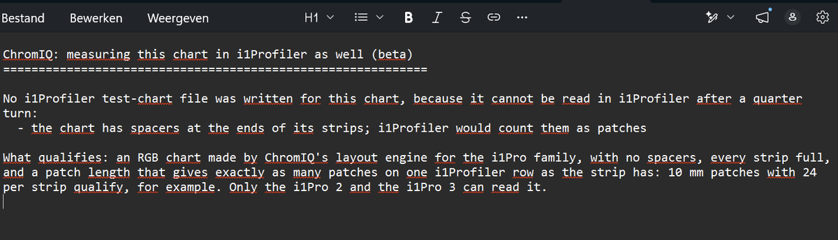

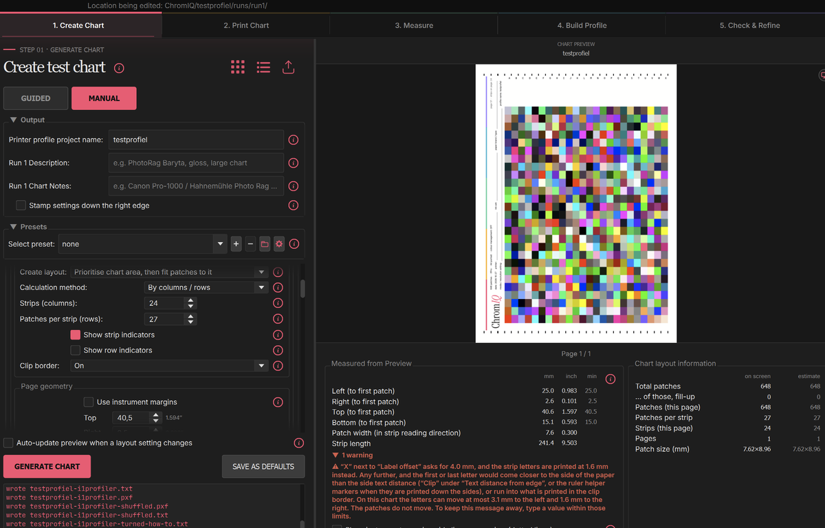

I tried it (504 patches: 21 rows of 24 patches), but still no txf-file:
Configuration is OK see patch size + configuration (21x24), but no txf file in the export directory:
