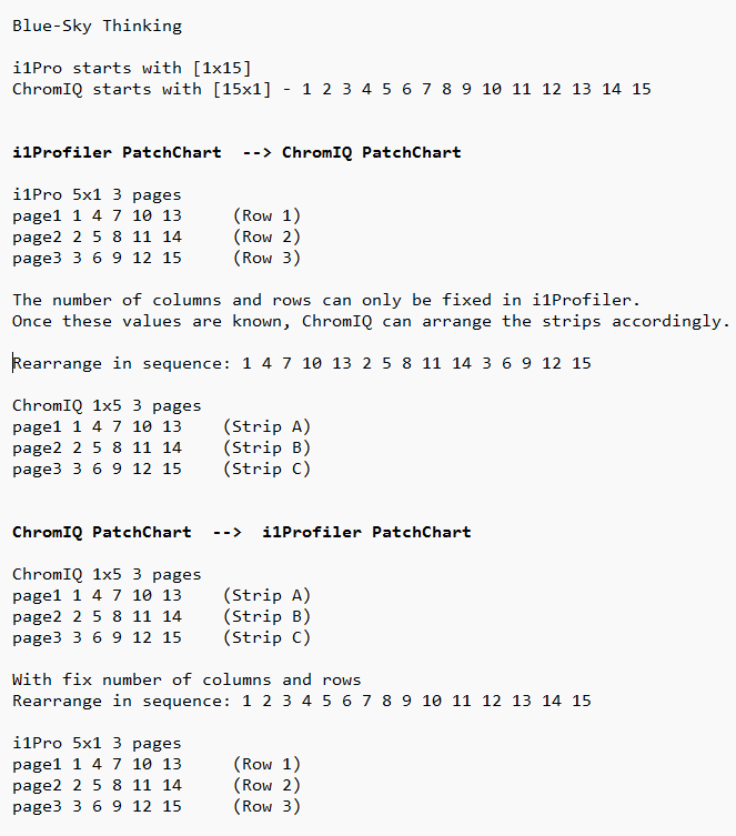

Are there any plans to export the ti2 working files towards i1Profiler pwxf working files so one can use the ChromIQ generated targets on both ChromIQ and i1Profiler as well. I believe @jctay is hinting in this directon to have universal target compatible to both ChromIQ (json/ti2-file) and i1Profiler (pwxf-file) ?
In the past before ChromIQ I exported my ti1 into pxf-files and use i1Profiler to generate the corresponding pwxf-file (similar to the ti2-file), but all the patches ar turned around (the row sequence turned into the strip sequence and vice-versa when exported from ti2 into pwxf format). So I think it must be not so difficult to do this export.
I have no plans in this direction. The AI did a quick analysis of this request when jctay made it but if I remeber correctly that wasn‘t as simple as one would think. Maybe I will look into this again at some point.
