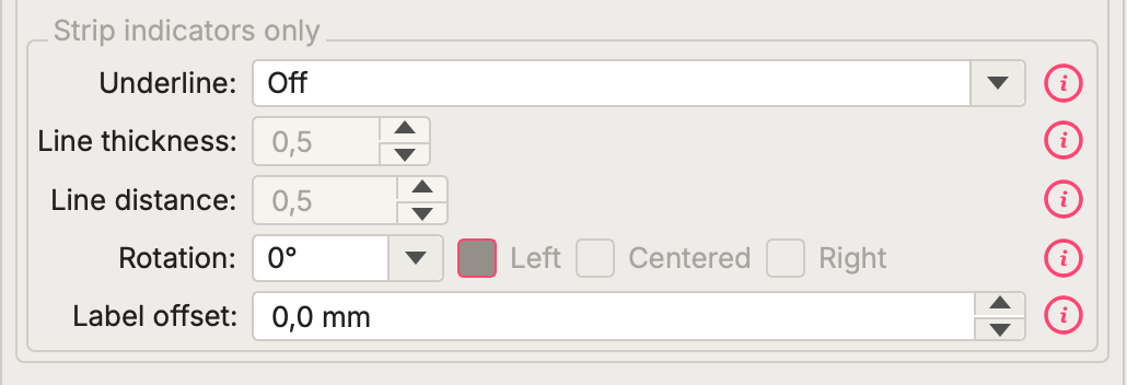

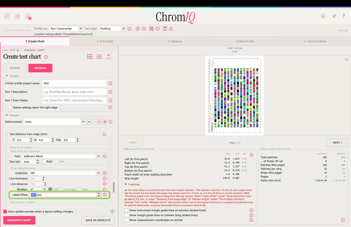

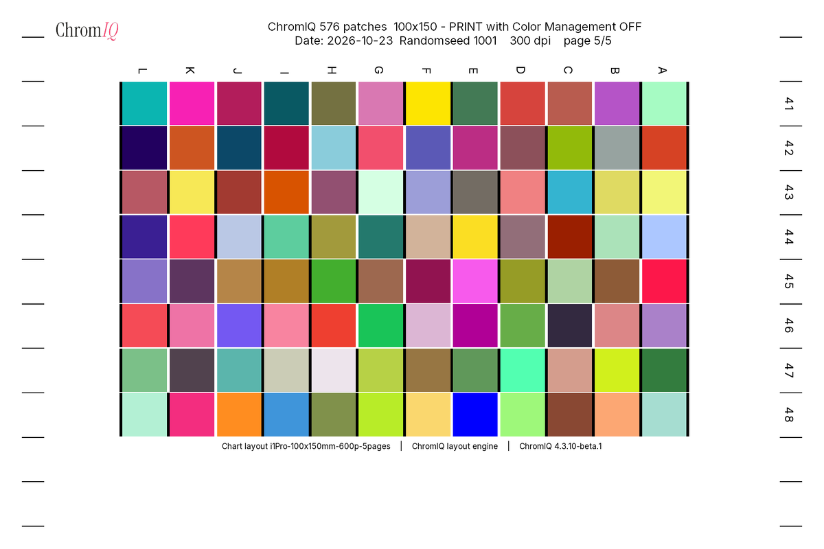

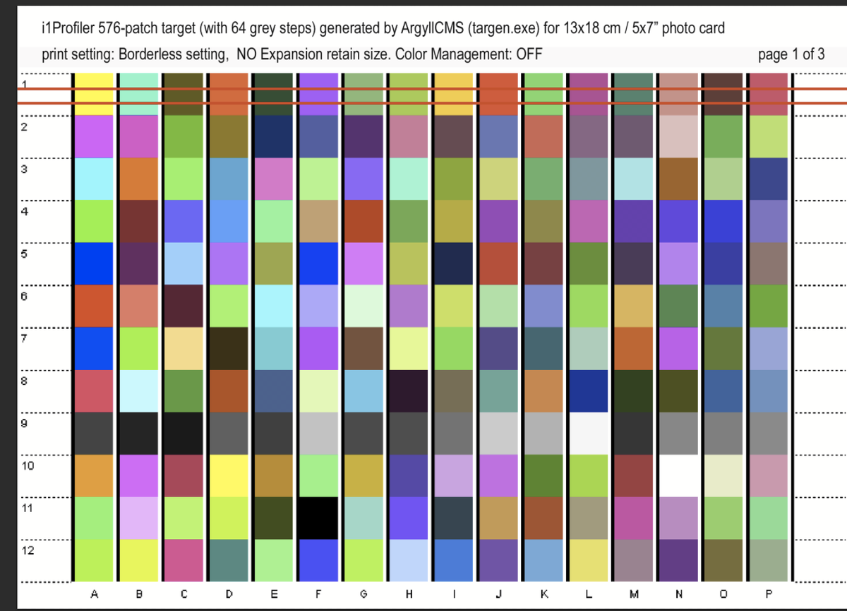

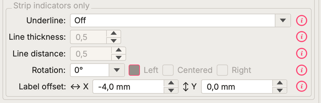

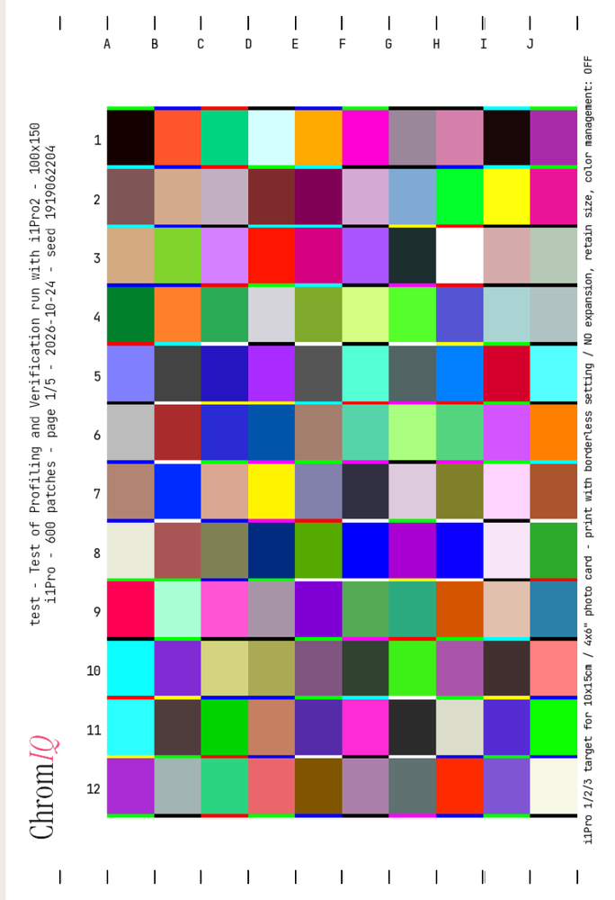

Is there a special reason why you prefer numbers as the strip labels? The default is alphabetic strip labels. Does it have to do with export to i1Profiler?
I guess we could update our presets to do as you did here, to put the labels in-between the helper markers and use two helper markers :)

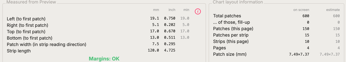

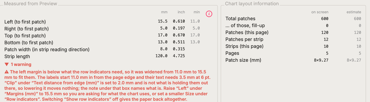

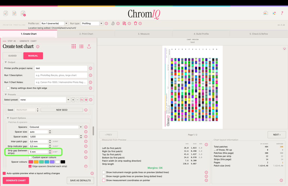

But many of the preset charts have 10 x 15 patches per page, so a little denser. And that results in the following measurements for the 600 patch chart:
Thw patch width of 7.5mm is the standard for most the i1Pro presets, as it is the densest patch without any issues reading them.
I guess your chart has wider patches?
