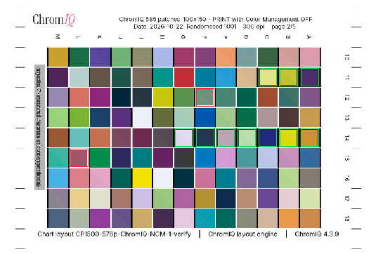

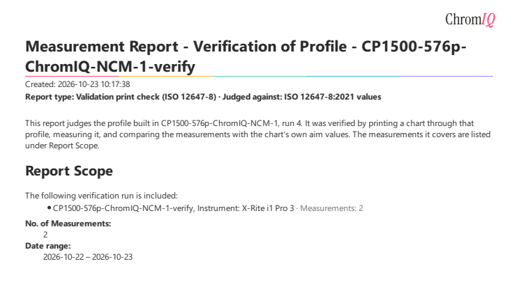

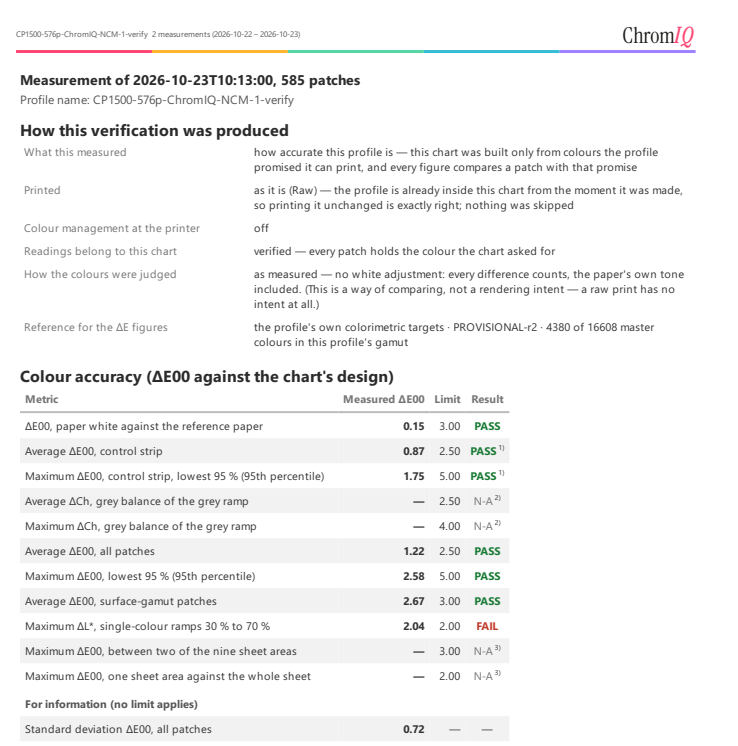

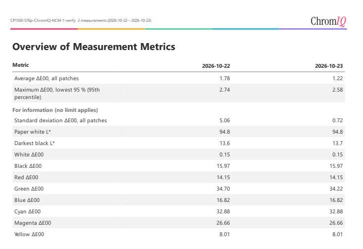

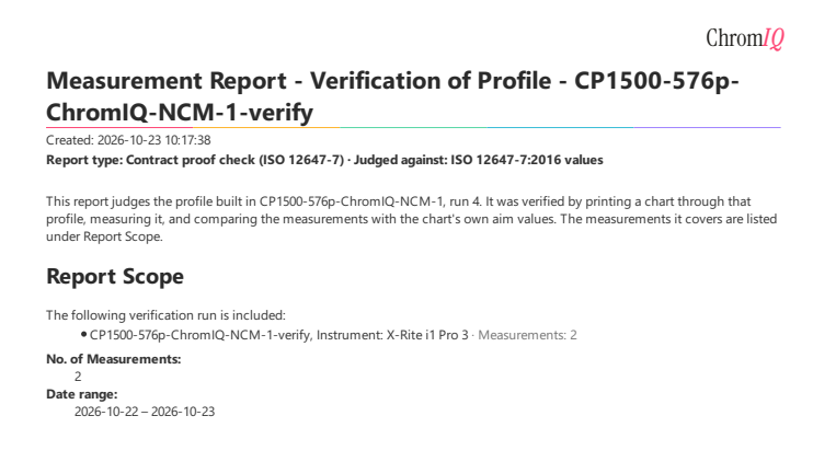

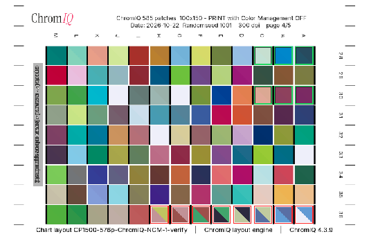

Oh, ok... I should have noticed. You say you used the 572 patch chart for both profiling and the verification measurement... That makes sense, since the Worst Patches all were strip number 36, and the 192 patch chart does not have that many strips...I used only the 576-patch chart, and the verification chart was generated using Profile Gamut mode.
The reports you posted have all the same problem, except the one-page report, which does not list worst patches.
