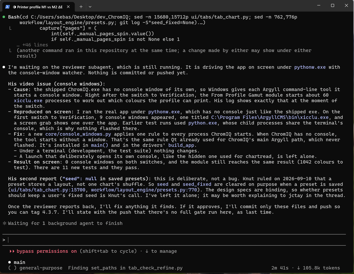

That's really strange. I will see what I can do about itIssue1: The command boxes begin to appear before the next working screen is displayed
After the ICC profile is built:
Click Create Chart.
Change the Run Type to Verification.
Observe the attached video.
Issue 2: Fixed Seed Is Not Saved in Preset
Preset files are stored in the following directory:
\Users\UserName\AppData\Roaming\ChromIQ\presets
Example file: 1Pro-4x6in-192p-2pages.json
Currently, the preset file contains the following values:
"randomize": true,
"seed": null,
"seed_fixed": null
Expected behavior:
If the user defines a seed value (e.g., 1234), the preset file should save that value in the seed field:
"randomize": true,
"seed": 1234,
"seed_fixed": null
The user-defined seed value should be saved correctly in the preset file and retained when the preset is loaded again.
.../2 zips are attached
Edit:
Edit 2:
Fixed:
https://github.com/itsab1989/ChromIQ/releases/tag/v4.3.7
