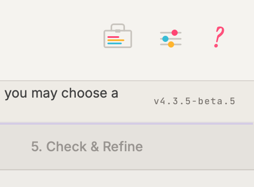

Strange that you have this issue. I suggest that you post the log files, as asked for several times. That is the only thing that will show exactly what you are doing and if the app is hitting some issue or bug. Please open the preferences window (the middle icon):

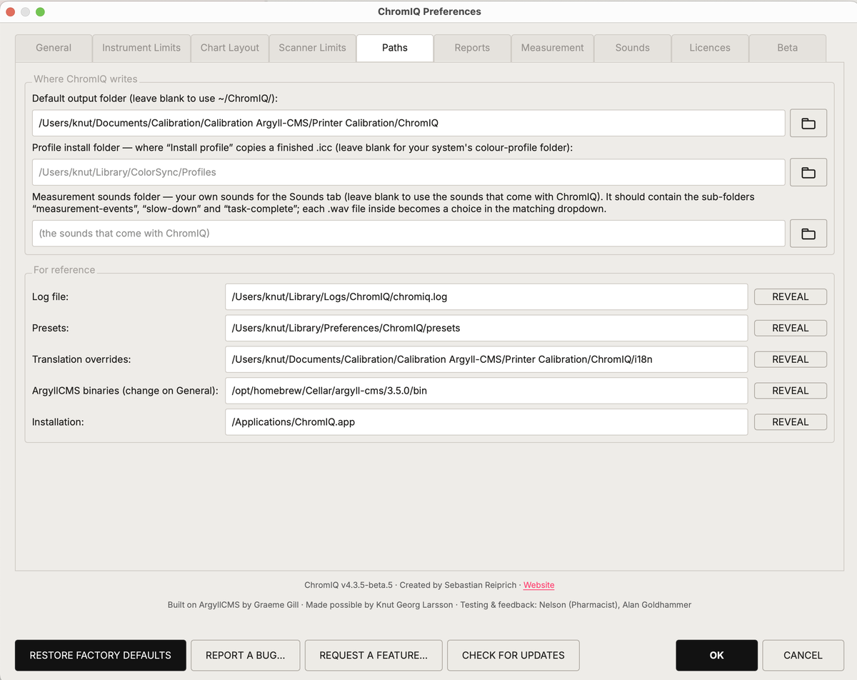

Go to the Paths tab:
Now click the reveal button on the Log file-line. For windows the path will be different, but the window and function should be the same.
Compress all the log files you have in that folder and post it... Then it can be analysed.
