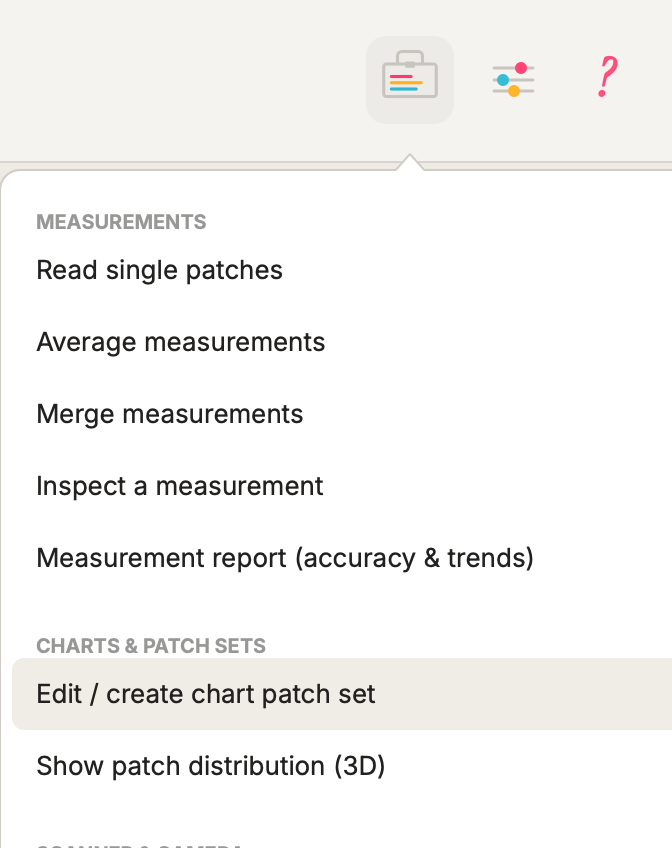

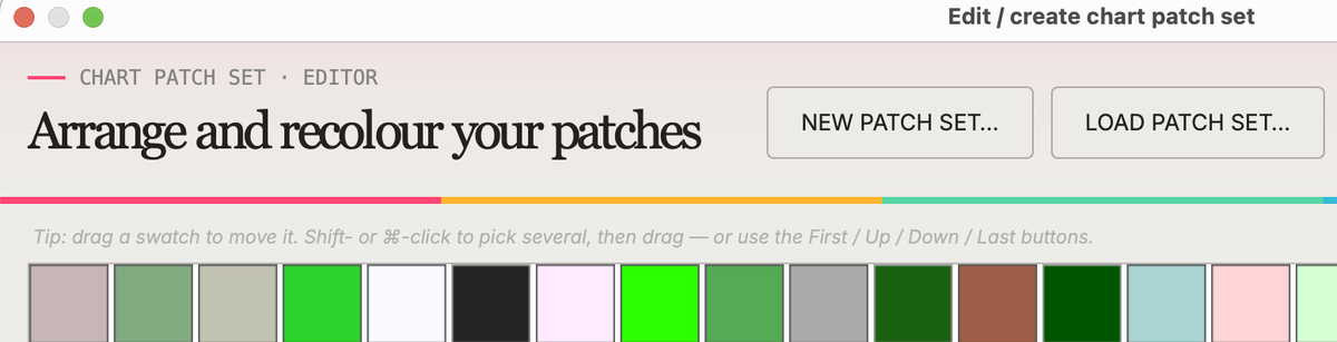

The 572 patch chart you are using has a single line of neutral grays, but after you fill the chart with "within-gamut-colour" using the "From Profile's Gamut" feature, that feature does not place enough grey patches along this line of neutral greys. I think this was possible a result of the work we did to distribute patches more evenly, but should be checked that the same amount of greys that are present in the chart from before is placed when using the "From Profile's Gamut" feature. This should be analysed.

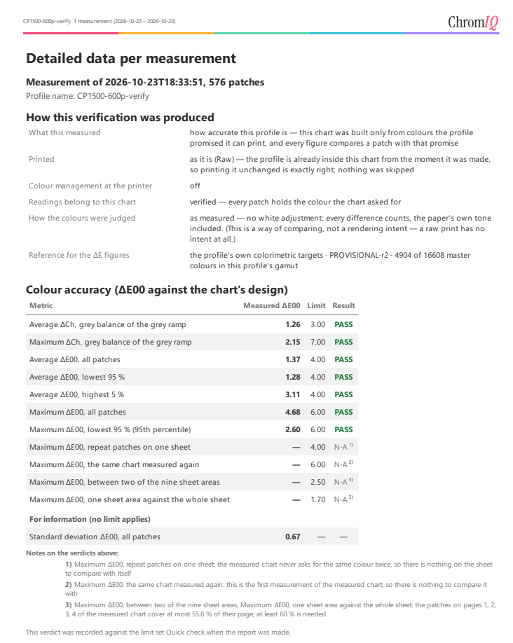

2. Evenness check requirements not fulfilled:

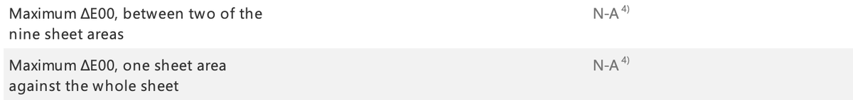

The report note says that the chart used only covers 55.7% of the page (and 60% is the required limit), which looks strange when looking at one page from the 572 patch chart:
If one adds all the margin areas, it might be true that this becomes mathematically 44.3% of the page... But that calculation does not consider that the patch area is spread out to cover most of the page and the margins are around the patch area. The minimum limit of 60% of the page area calculation, and the method used, needs to be re-evaluated so that the calculation takes into account that the patch area is spread evenly out on most of the page, and not purely looking at a mathematical area calculation, since the margins summed up give a false impression of the whole page coverage of the patch area. Dropping the limit to 50% is of course also an alternative, but this method, as I mention, is a bit misleading to represent coverage of the patch area across the page.
The chart also fulfils the other requirement for the evenness checks to be calculated, which a minimum of 9 by 9 columns and rows. This metric should work on this kind of chart.

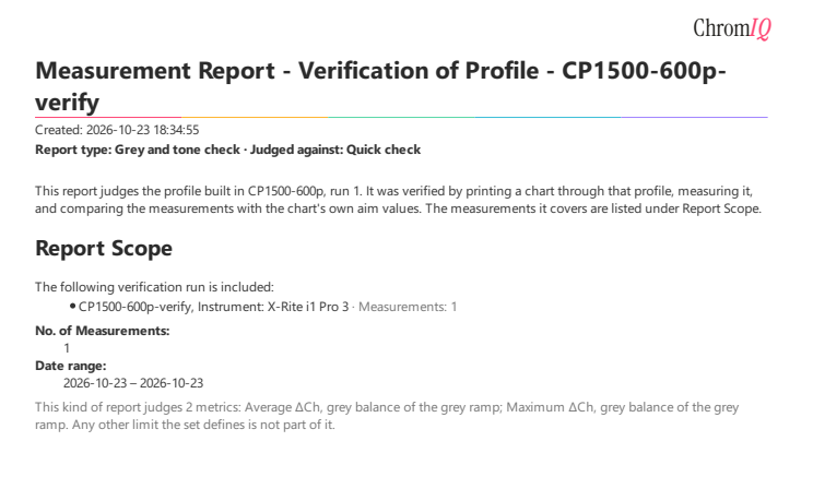

Printer Profile CP1500-600.icm (600-Patch Set)
1. Patch Distribution Verification Patches vs. Profiling Target Patches
Patch Distribution Verification Patches vs. Profiling Target Patches 600patch.png

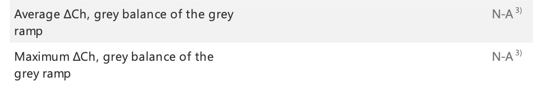

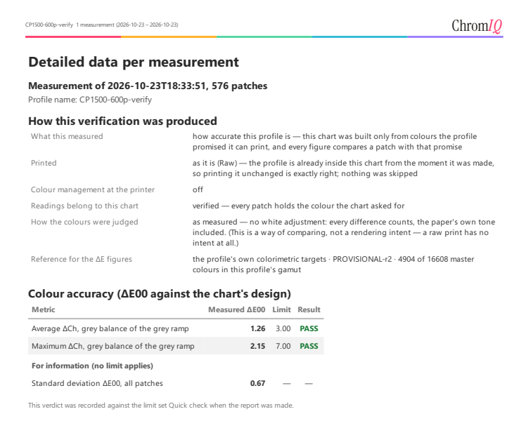

2. Grey and tone check · Judged against Quick check
3. Full colour check · Judged against Quick check

Nice... you got better results with this chart I think
The reports
"Contract proof check (ISO 12647-7) · Judged against ISO 12647-72016 values" and
"Validation print check (ISO 12647-8) · Judged against ISO 12647-82021 values"
are telling of great quality I think :)

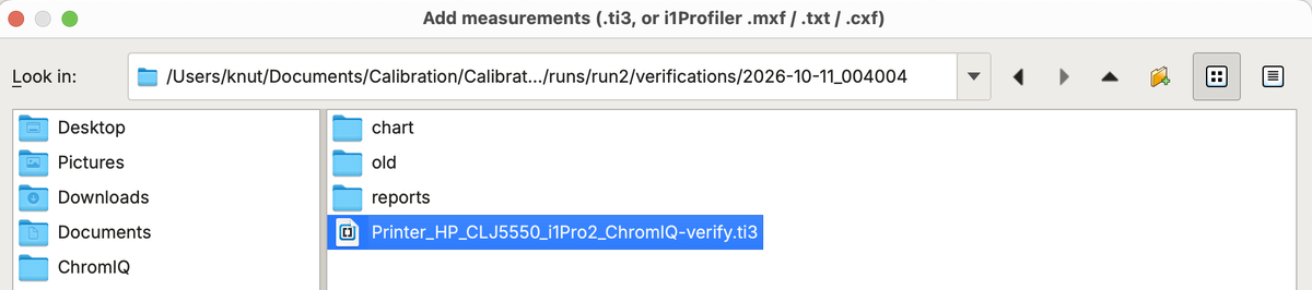

I notice you are creating separate projects for the 572 and 600 patch measurements. That is fine, but I hope you know you can create new runs (run 1, run 2, run 3 etc) and have all the different profiling attempts within the same projects, for example by separating the runs by paper type, or just by the different charts you use... You can use the run description field to differentiate the various runs...
Another tip:

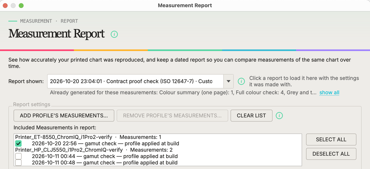

If you would like to compare the measurement report from one run agains another run, or, in your case, a run in one project against a run in another project, then you can do this by adding the measurement you want to compare from the other project. Click the "Add Profile's Measurement" and navigate to the ti3 file on the other project (under the verifications folder, and the dated folder for the verification measurement).
The measurements from the other project will then appear:
You can then select which measurements to include in the report and then you will see the results side-by-side, and if the 572 patch chart was better or worse than the 600 patch chart :)
Would be interesting to see ...
In my example above, I chose two different printers, but preferably they should be the same :)
