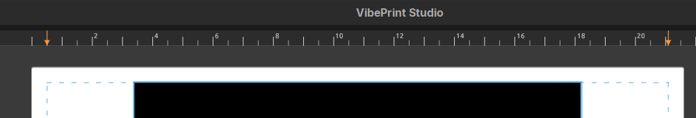

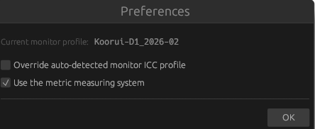

Allright it's done :) If you pull from git and recompile, you should find an option to switch to metric in the preferences menu. This is found in the "hamburger" icon above the folder browser
The option switches all the print sizes from US sizes to the "A" standard. It will also switch the paper border option to millimeters.
The previer ruler also changed to metric

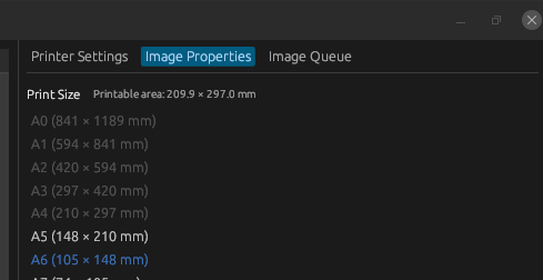

One hint I never thought of giving here. If you pick A6 paper in your driver, it is technically NOT POSSIBLE to select A6 in the image properties. This is normal and the reason is that your actual printable area is smaller than your selection. Use "fit to page" in this scenario. I wasent sure how to handle this scenario. Qimage will let you select any size and tells you it's too large to fit (or auto-crops). I prefered only allowing images sizes that actually fit. Here is an example with A4 paper in the driver. A4 is grayed out
I hope you enjoy the changes :) I might eventually figure out some hybrid method for people like me in canuckland (US paper sizes but a preference for cm and mm for everything else)

I'm not sure I would call myself a developper but thank you! It wasn't too hard adding the extra sizes. What took some time I'd changing every other box where the user has a possibility of entering a value
For the weird Canadian scenario, and perhaps other locations, I'm thinking of options where the user would be able to enter something like "8.5i" when the software is in metric mode and simply having the software doing the conversion on the fly. (and vice versa.. Say 10m or 10mm if the software is in non-metric mode)
Any thoughts on the idea?

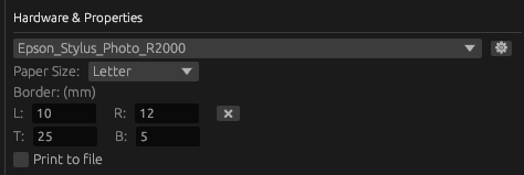

4abc. By popular demand, the program as of 15 minutes ago allows four individual borders. I was already pulling the information from CUPS but for simplicity, I was using the highest of all values all around the page. For the handful of printers I was testing with, it was fine and it was a good place to start. This should allow to set a border for whatever needs you have be it special image placement, binding, etc. combined with "fit to page" and the crop editor, you can probably come up with the exact layout you need

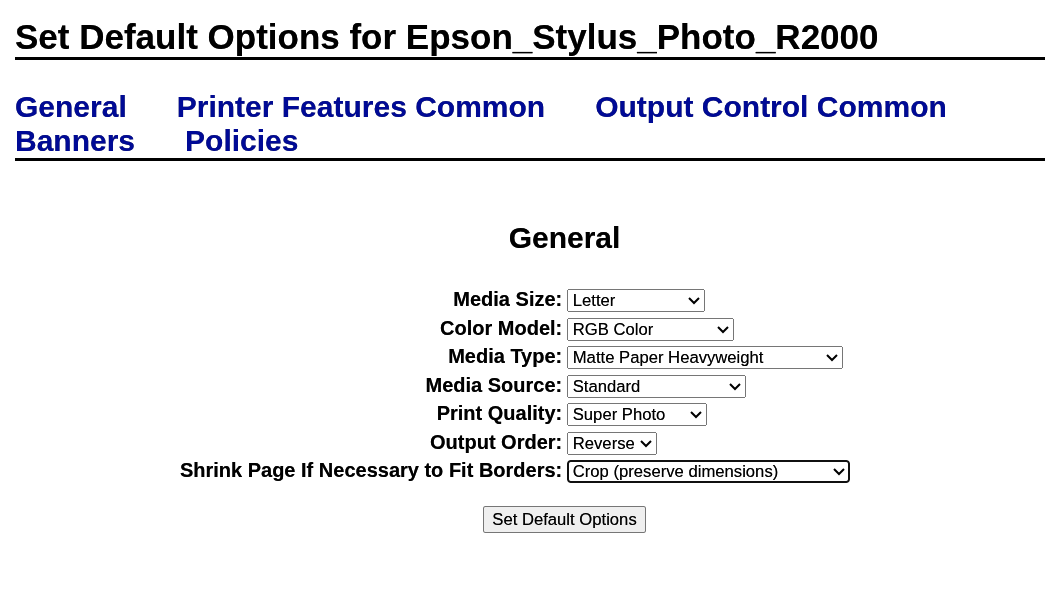

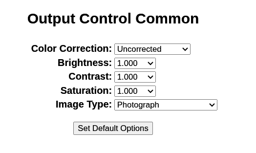

Color correction needs to be Uncorrected. Anything else will skew the output
This can also be done in vibeprint itself
Of course, your profile needs to be built with these exact same settings. Vibeprint currently does NOT have a target printing mode because it needs to bring in multiple images into a common color space (I use a linear version of Prophoto RGB which is basically what lightroom does). I just print targets like this after settings defaults lp -d Epson-Stylus-Photo-R2000 -o scaling=100 -o cm-calibration=1 target.tiff the "cm-calibration=1" is KEY to an uncolormanged print. This is basically how I defeated double profiling.. Vibeprint applies the profile and all steps from there to the paper are neutral and modify none of the RGB values in the image. There is one situation where things might not be perfect. If there is no guttenprint driver, the CUPS will install it as driverless. This is a mode where CUPS will just send some standard commands to the printer and all color is managed by the printer itself. Linux calls it IPP, Apple calls Airprint but it's exactly the same under different names. You can't really profile in uncorrected mode but you can still create a profile for the "blackbox" that it is. I'm almost certain that the Epson ET-8550 falls into this category on Linux (unless you use Turboprint). The profile will probably just a marginal improvement but it still helps. I'm doing this for my brother MFC and it did correctly compensate for my third party catridges. Keith Cooper does something similar with a Canon on MAC

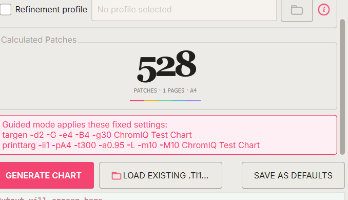

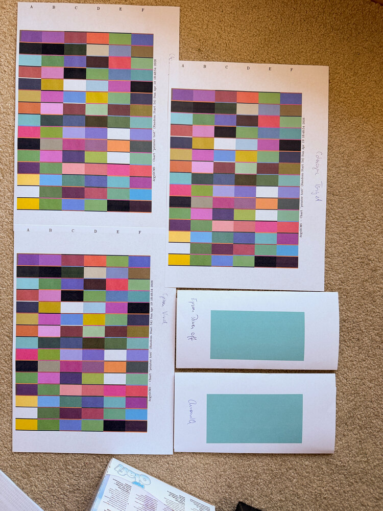

I noticed that you mentioned the ET 8550 here. I am working on a GUI for Argylls printer profiling part and wanted it to be able to print the necessary test charts. So for the printing implementation on my Mac I did quite a lot of testing with my 8550. i printed the same test chart with various different settings to compare it with my own apps printing implementation. To my surprise no matter how I printed it (my own apps two different printing implementations, Adobe Color Print Utility, Apples ColorSync Utility as a target, in Preview with Colormanagement disabled in the printer driver or in Preview with Epsons default Epson vivid setting!!!) they all turned out to be the same. I only have a Colormunki (so no i1Pro) but I made multiple Spotreadings on the same patches on different charts and they were indistinguishable.
The photos are obviously not the best way to compare the targets because they are not evenly lit. But while the targets are pretty similar you can hopefully see a difference in the photo I have printed. With Epsons default settings it has a magenta cast. With an ICC profile I created it looks more neutral.

I just installed your latest versions:
something small need to be corrected:
-g30 suddenly instead of the previous -g32
