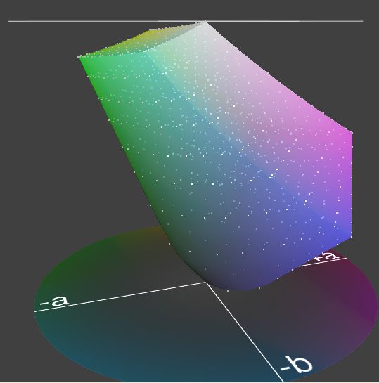

I'm not using Colormunki, but the old X/Rite Profile Maker software, and with it the even older Monaco GamutWorks Viewer which has some nice features.
I'm displaying here the sRGB color space, in actual colors and within this colorspace white spots which are the colors of the spots of my profile target with 968 fields. These spots either sit on the
outer surface of the color space volume or are visible within - evenly distributed. All sections of the gamut are equally well covered with measurement points on which the profile generation software is based on, creating a correction value for these from the scanned printoit.
If I could get a .tiff or .pdf file of the Color Munki target I could add this here as well, and it would show where the target spots within the gamut are located, and as well those of the optimization step. If Color Munki does not let you save the target as a file, you maz print it with a PDF writer into a .pdf file.
I don t think the opt. process is supposed to expand the gamut overall but to add some more measurement points to the process to make the profile more accurate in this area.

my image above shows the target I'm using, and how the target color spots fit into the color space, and how they are distributed across the gamut volume. I hoped I could show the same using the Colormunki target which uses much less spots than my target - 918 vs. 50. I tried to install Colormunki but without the device I cannot even get into a demo mode. If you could print the target to PDF please, not to your printer, with a PDF writer as a virtual printer generating a PDF file from the print output I would use that for illustration. There are several of those, Acrobat, CutePDF and others. I'm not looking to the opt. target yet. But when looking to http://www.colormunki.com/munsell# under the 'Images' tab there are a range of images and apparently those colors used for the additional optimization process extracted from these images. Since I'm not using Colormunki I don't have an idea what the button to the right does ' Add all patches to my pallet'.
This is my standard target
and the color values of all the spots are recalculated into Lab values and displayed above in a
3D Lab viewer, and each target spot is a pixel in the color space. It is quite an unusual display of the target data, but this function of the Gamut viewer can be used with about every image which then shows it as a pixel cloud in the color space
