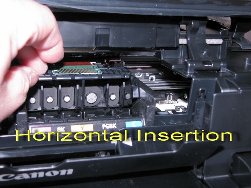

Here are some intial discoveries. I could not see any instructions in the manual about removing the printhead. So I proceeded to see if it can be done and the answer is YES. You simply pull on the front bar and then the printhead can be removed in a rotating fashion following tracks on the side rail.
If you look carefully you'll see the PG seal is missing in some photos it dropped out while handling the printhead. Hmmmmm..
Timing strip is hard to reach. Canon does test with color cartridges during assembly and then installs a new printhead inside the printer. The ink inlet screensdo not appear to be SS anymore.
Initial batch of pics.

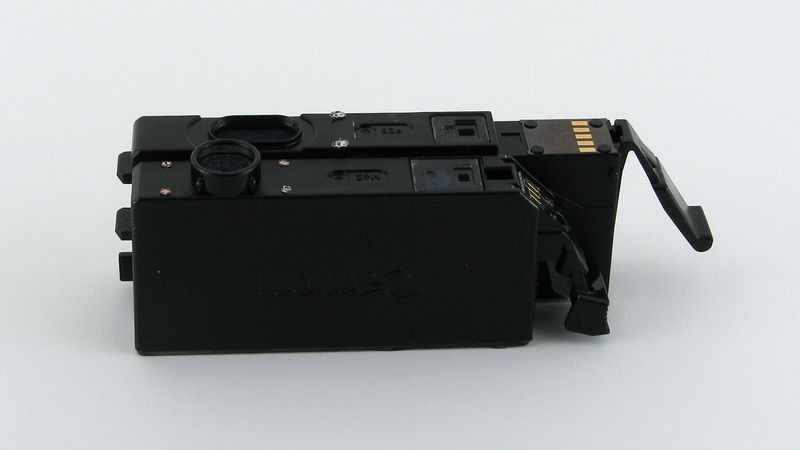

What is more interesting is that that output when no color matching is done is odd. Most times, the printer firmware and ink is optimized so that the output with no color adjustments tries to get the greys correct. In this printer, with OEM ink, the greys in this mode is brown in tone...but the colors are good. Now this testing is done with the hugely popular Kirkland Professional Glossy and Canon paper might be better but the greys are so off I am shocked. If the printer driver is put back into managing color, the grey returns. This indicates that huge corrections are being processed by the driver ( in a limited area) and that custom profiles may not work as one hopes on these machines. Is this to mess up custom profile algorithms that assume a linear output and color shifts that affect all colors...hmmm
The other thing that comes up is this. That most of the ink contained in the original cartridges are in the sponge. The cut down reservoir is tiny. If one uses the German method to refill, the ink in the reservoir would be quickly used up nearly immediately saturating the sponge. (The length of the reservoir is exactly the length of the optical window). This would require filling multiple times and inverting to resaturate each time to get the sponge resaturated. Given that the reservoir is tiny, the best method will be the topfill to ensure that the sponge is saturated to what it is supposed to hold...the user is going to need it.
