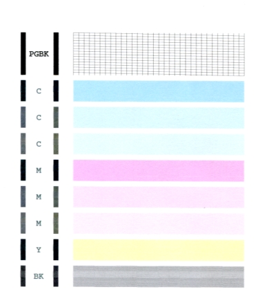

I have just finished unclogging an MG5250 bought from a thrift store at DKK 50 or 7 or 8 € or $. The pigment black was totally missing, meaning same error as described by iml and palombian. Click to enlarge:
A stamp test showed the pigment black nozzles were clogged, meaning the print head most likely did not suffer from an electronic damage and could could possibly be saved:

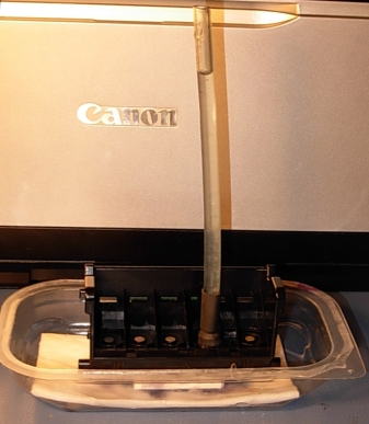

I placed the print head on a paper handkerchief wetted with pharmacists cleaning solution in a tray and pushed down on the print head several times. After some time traces of the pigment black started to show. After more "pumping" much more ink stained the paper handkerchief, and I changed it and repeated the process several times with several new handkerchiefs and pauses between pumping. After several handkerchiefs and a couple of hours I attached a piece of plastic hose to the pigment black ink inlet and filled it with pharmacist's cleaning fluid and just waited for the fluid to disappear from the hose, indicating the nozzles or at least some of them had been unclogged:
Shortly after having finished photographing the setup, the cleaning fluid in the hose had disappeared. I made sure the print head was dry and reinstalled it in the printer. I ran a normal, not deep nozzle cleaning and most of the pigment black nozzles were back. After two more nozzle cleanings I got this nozzle check, click to enlarge:

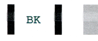

As can be seen the unclogging was a success, and the dye colours are also good, but sadly the dye black nozzles look to have suffered thermal damage, maybe caused by an unsuitable ink, no cleaning can correct this error:
It is very important the print head is dry before reinstalling, else it can be damaged and it can also damage the logic board, making the printer a total loss. Water or cleaning fluid can be trapped behind the ribbon cable and the circuit board on the back side of the print head. See this. Also see this and this.

As for the BK patter displayed. This could be a sign of delayed firing. The nozzles are possibly insulated with dried ink preventing heat from quickly heating the ink. I would install a cleaning cartridge with some windex in it and over a period of days see what comes of it.
I have some printable liquid that can be used instead of windex that will not leave deposits and it is safe in the print mode just like ink.

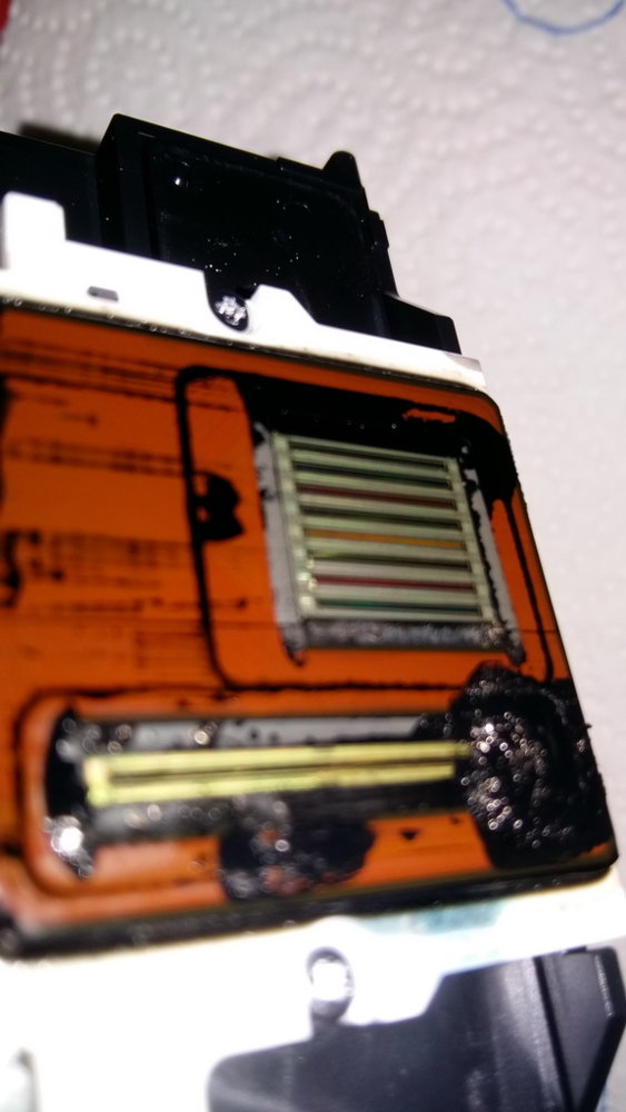

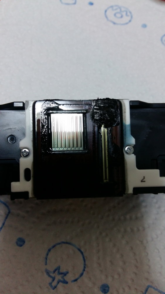

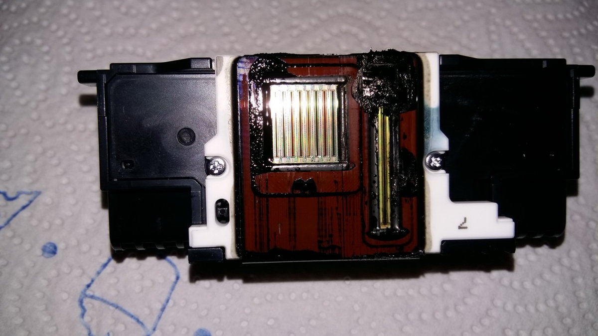

Just 5 fills. You will see the poor condition the head is in and you will freak out (as I did)
I probably have to test the purge system next. There is not much clearance with the newer canons to safely spill some water there with the syringe. For now I will be soaking the printhead following @stratman's extra encouraging instructions. Fairy it is for me.
Question: Wouldn't water stay in the waste pads filling them prematurely with this purge test? I suppose that the "upper tank" (where the printhead rests) doesn't take much to fill but I have some second thoughts.
From the photos you can see that even with a... chisel I could probably partially unclog the printhead. No amount of normal cleaning cycle could unclog this. How did it get so messy?
I'm also curious about the -I guess- pigment concentration especially around the dye color nozzles. What is it doing there?

After soaking the PH for 48 hours in distilled water with fairy and pushing the PH to a paper handkerchief from time to time, then replacing the solution used, I left the PH for almost 3 days to dry. Would have been more (I think I totaled my last PH due to not being patient enough) but I needed to use the printer. The colors took some time to appear (had to wait several hours and extra 3 normal cleaning circles between nozzle checks) but now I have a perfect nozzle check once again.
:celebrate
PGI-Black and CLI-Yellow are canon OEM cartridges now and I will be replacing the other ARC cartridges as soon as they are declared empty.
Oh the joy...!
A big "THANK YOU" for all the help you gave me
Meanwhile, I cleaned (the best I could) wipers and whatever I could reach from what I reckon "too much pigment black".
The purge test is yet inconclusive. I could see the squared purge pad emptying after a cleaning circle, however the long-narrow one (for bk-pigment) is to far from reach, narrow and shiny from all the excess bk color to be sure at this stage. I will have to come back on that.
