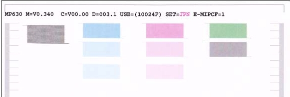

Congratulations with entering service mode and using the service tool to produce the test print. Well done :). You could try improving the scan by tweaking the scanner settings, for instance reducing light and increasing contrast. You might find a settting that makes the test pattern more visible. You can also crop the scan and use a higher resolution, the whole test print is not needed, only this area, I think your extended nozzle check should look like this if 100% OK.:
An electronic failure in the print head will show a regular geometric pattern, clogging will show a random pattern. I had expected to see magenta test stripes like this:
It is very hard to see, but I see only a random pattern no geometric pattern in the missing nozzles. This means that most likely @The Hat is right and the print head is severely clogged and that cleaning the print head might help. As the print head seems to not be damaged electrically, chances are good that a new print head will bring the printer back to good working order,if cleaning is no success. If you clean the print head outside the printer, be sure it is completely dry before reinstalling it. Water left where it does not belong especially behind the circuit board on the backside of the print head can kill not only the print head but also the the logic board, making the printer a total loss. If you can find a new print head for a reasonable price is another question.
