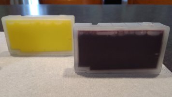

I just finished to refill the PGI-1200 BK OEM with 35ml, put it back in the printer.
The color tanks are still the aftermarket ones (for the moment).
The print nozzle is perfect, but the ARC does not seem to trigger the right level.
This is probably because the ARC thinks the cart is the aftermarket one and takes into consideration 55ml as full, while it is now 35ml :(
Any thoughts?
In the meantime, I carry on with the colors.
Alex
7,177
The chip does not think in the manner you suggest. The ARC chip does not care or consider how much you refill or what cartridge it is attached to.
My understanding of ARC chips is they reset either
1) Whenever you take the cartridge out of the print head regardless of ink volume left over.
or
2) You must wait for the chip to declare the cartridge low or empty and then remove the cartridge.
According to Precision Colors instruction for refilling, you must wait until you see a "?" about the cartridge in the ink level monitoring window/screen before refilling it. If you do not wait then the chip will not reset and the chip will continue to count down sprays until it reaches its mathematical conclusion (independent of the volume of ink in the cartridge). This would be scenario #2 from above.
Take a look at the refilling instructions on Precision Colors.
What precisely did you do/ see when you refilled?

Look, the carts I removed were 3/4 full, I could not certainly wait to finish the ink with those carts, they were a disaster.
So what you are saying is that at a certain point, the printer will tell me that I am out of ink, but in reality that won't be the case.
I assume, at that point, all I need to do is to refill the OEM tank to full so that the chip will be in sync with the level of ink. Am I correct?
7,177
Yes. If you have more ink than what the chip registers then you will be prompted that the cartridge is low and to act and you would not run out of ink before the chip alerts you.
Perfect, so it is just a question to wait for the printer to report the out of ink, and then, once ARC and ink are leveled, they should be in sync.
Now, I want to see how the printer behaves when printing after one or two days, hopefully the problem has been resolved. The nozzle check is perfect, but I will print another one tomorrow to verify if it is still perfect.
Keep you posted folks.
