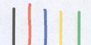

I have a problem as you can see with vertical lines. I'm printing a lot of images, and images start to look like that. If anyone can help me...?
