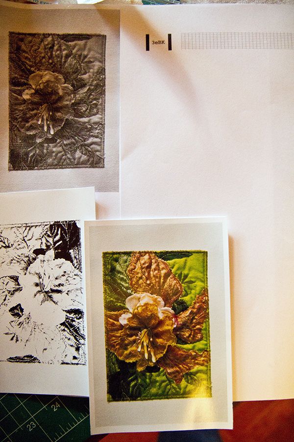

My Canon Pixma IP5000 has suddenly started to print black only when I try & print a colour photo. If I tick the greyscale box it will print a greyscale photo but unticked & trying to print in colour it will only print in black with no grey tones. My nozzle print for all inks only shows the pigment black ink with no headings for the colour inks. This happens on two different computers so it seems to be printer related.
Anyone have any ideas on whats going wrong? I have also done a deep head clean & all OEM cartridges are full of IS ink.
Here's a shot of my nozzle print test with only the Pigment ink showing & none of the colour nozzles. The greyscale shot (top left) which is OK & the black only shot (bottom left) which is how it printed in colour mode & the colour one is from my pro9000.

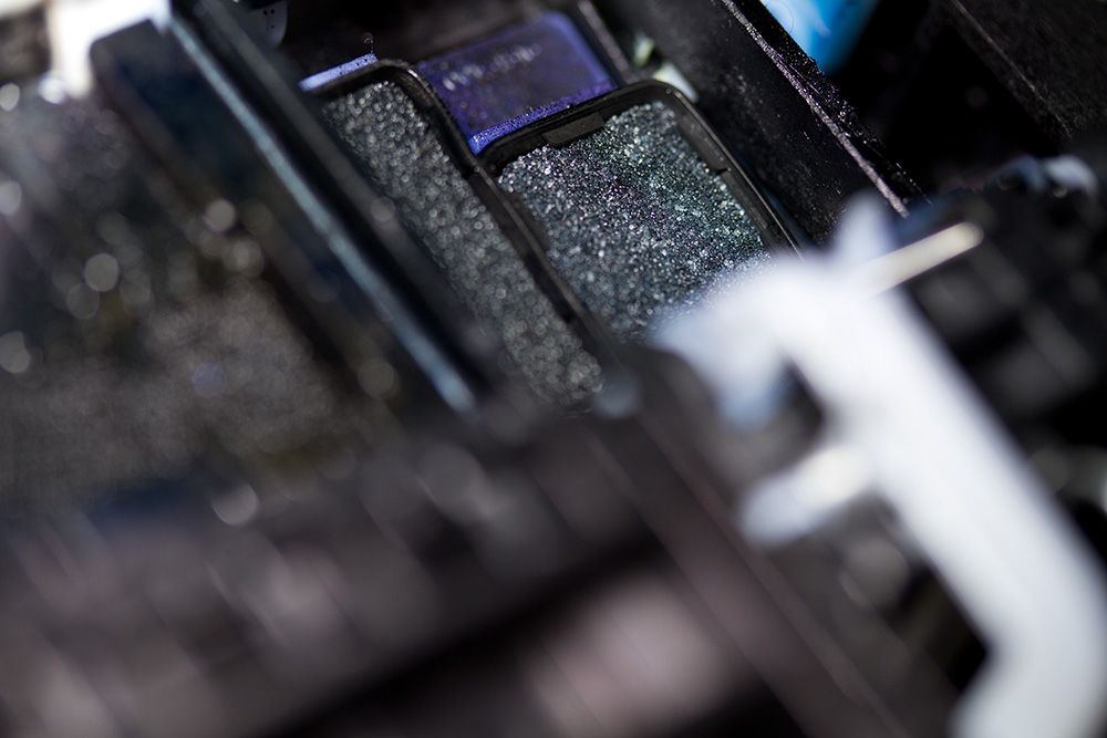

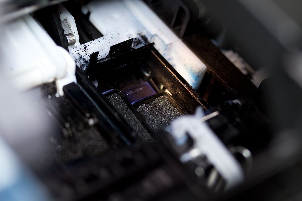

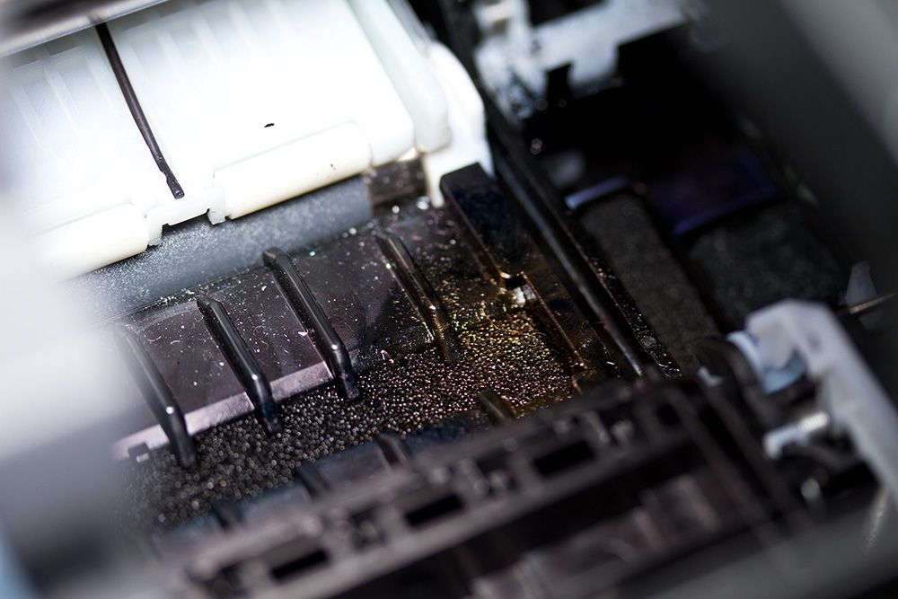

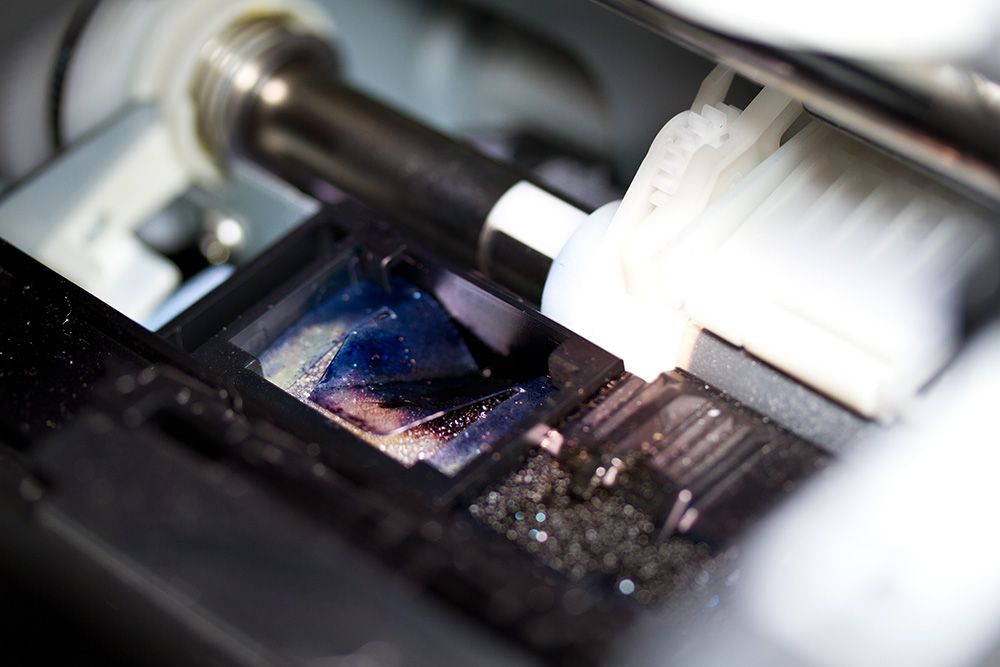

I put a drop of water on the waste pad & it soaked in straight away, I put one more drop on & that did the same & the sponge went white where the drop was.
I've now got the head soaking & when it's dry I will clean the contacts & will try printing again.
Here's some shots of the ink pads, there looks to be some ink spots on the plastics & some messy ink just left of the ink pads.
I also saw another pad with clear plastic for ink to run down on the left of the printer.
Left side of printer
Here's the ink pads
Just left of the ink pads with messy ink.
Some of the ink splash around ink pads
8,712
7,173
Rod:
When did you turn into a dainty old lady? A drop of water on the waste pad? :barnie
You need to flood the waste pads, meaning more than two drops, in order to see if fluid pools. Less than a cc may do the trick, but certainly more than 2 drops. Whatever you do, resist the urge to piss on it like you say Aussies do on everything.
If fluid does not pool then it could mean the purge system tubing has become disconnected.
