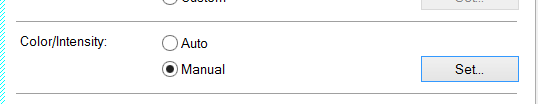

Essentially, you need to manually set the Canon printer driver color management setting to NONE. Then you select the proper ICC profile in your printing application (eg InDesign).
From the Pro-1000 manual:
https://ugp01.c-ij.com/ij/webmanual...eries/1.0/EN/PPG/dg-c_color_correction03.html
Google "canon pro 1000 turn off color management" for other examples as well as differences in performing this with Windows vs Mac.
