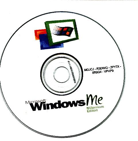

Knightcrawler,... I've read your posts over and over and I still don't see the problem. Any time you put any kind of "Image" in the project, Canon will print the entire creation as an image. It does not mix text and image,... it is either all text, or it is an image. It it is an image, all colors will be made out of what ever "Color" ink carts your printer has. If you are not able to print real "Black", then one of your C,M,Y, Pc, Pm, colors is acting up and your nozzle test should tell you that. If you can't print real black on your nozzle test you'll never be able to print an image that has total black. Here is a CD that I have made for some older PC's;
While it only has a very few items that are totally black,.. when they are printed they come out all black. This is a jpg image so it is an "IMAGE" and all the words are printed as an image and the black comes out black.....
I must be missing something?

Trigger 37:
You keep posting the same information, I have owned a 6600d for about 2 years and I'm aware they have a photo black cart. I have no problems getting that model to print true black on cd/dvd media. This thread is about the lowly iP3000 and any 3 ink model producing composite black on media and any tricks that might improve it.
