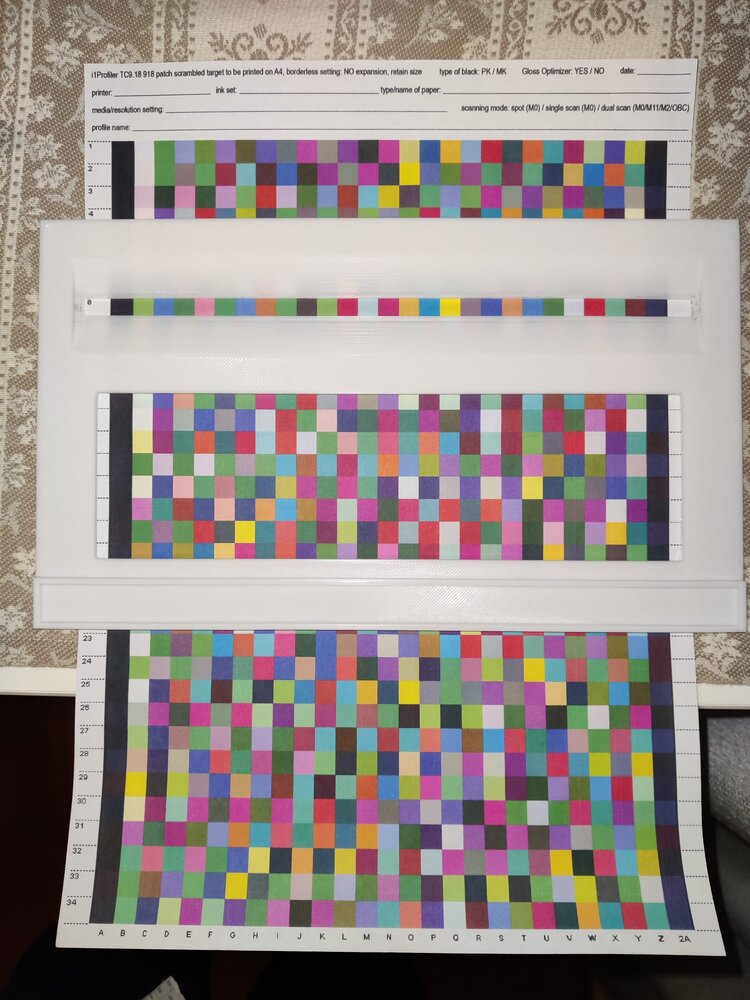

@pharmacist today i tried to use your enlarged ruler (we used a value to increase the length) to scan using i1profiler v3.1.1 for Mac with my i1pro (EFI-1000) but with no success,
I could read 24/25 patches versus 27 of each line, the ruler is not long enough to permit the read of all the patches on a row (the hole for the sensor is right, but the channel base for the rear is too short, it doesn't permit to the i1pro to reach the white spaces at the end of the sheet), so maybe i will need less patches maybe larger (so the scanning has more readings for a single patch) and more white space at the edges of the A4 portrait.
Maybe could be also a bad scanning method, i don't scan patches from months, but i would like to give a try with bigger and less patches with more white spaces on edges.
So if you have some time and you can create another set of 700/800 patches for an A4 in portrait maybe i can try again

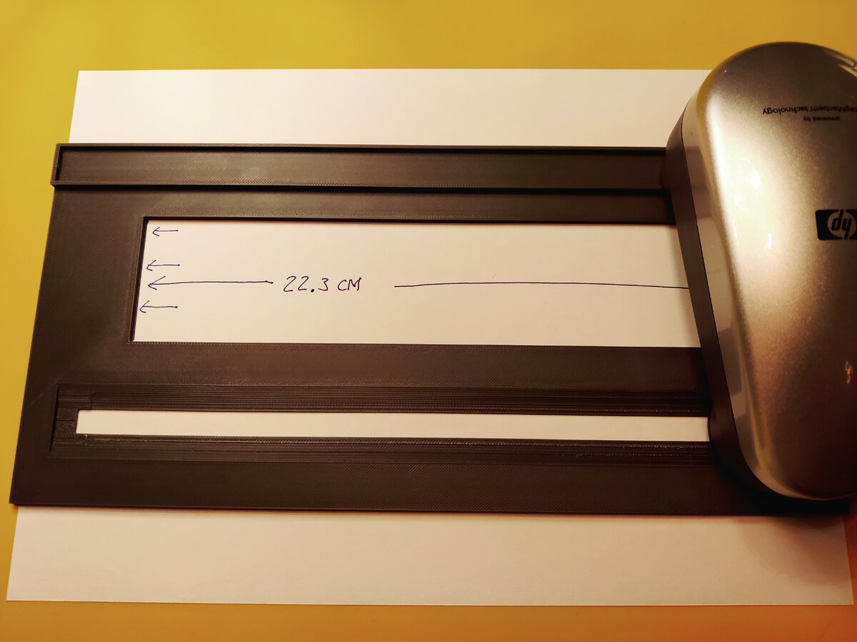

Tell me first the maximum distance you have between white and white area using the ruler and tell me the distance for example 24 cm, so I can make a target for you.
The area is exactly 22.3 cm as my design takes into account the scanning eye will start en stop on white paper and in between the row length must be 22.3 cm long:
The area is exactly 22.3 cm as my design takes into account the scanning eye will start en stop on white paper and in between the row length must be 22.3 cm long:View attachment 18043
the big window is 20cm large (why so short if i enlarged your project ?), so i suppose is this the problem.
the sensor window is 21,2cm large

if you see the image, instead i can't reach the left and right white spaces when i reach all left or all right with bottom of the i1pro, the top sensor stops in line with the bottom of the ruler but it hasn't enough space to reach the left/right white spaces, i could rotate left or right the top to reach the white spaces, but it doesn't seem work right
don't take this sheet seriously, it's a simple test on normal paper
Can you tell the hole measurements ? From your photo your hole seems wider than mine
maybe my hole is not enough wide

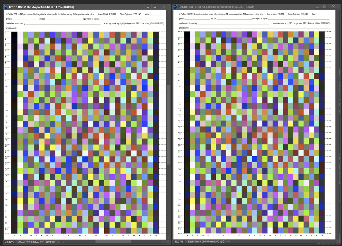

My scanning eye opening is 25.5 cm wide, so not sure how much the width is of your scanning jig ? Here is a new design I made. I hope your 3D-printer can print this size.
Meanwhile I have shrinked the target a bit in order to fit your smaller scanning guide. BUT you have to move slowly now in order to pick up enough sampling points as the patch width is now very critical.
See picture here: left the original target and on the right the shrinked version so hopefully your scanning guid will encompass the whole area:

just try the file above and see if it works for you (shrinked version TC9.18).
