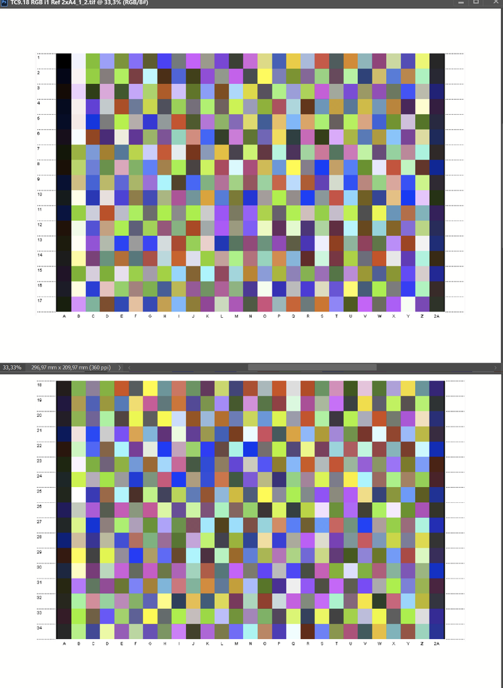

i'm approccing to use this method, maybe i got a v3.1.1 of iprofiler per Mac OSX that would work with my i1pro (i have 2 of them), so i would like to know if you have some target patches profile optimized for the i1pro on a single A4 sheet, you talk about a TC9.18 but i don't know where to download it.
I'm looking for a profle for B&W and Color printing, if then you have 2 of them optimized one for Color and one for B&W i could also make 2 profiles for each paper always on A4 sheets.
For some paper i have few o no informations, so i will have to test them for different Media types, if you have also a target patches for 10x15cm so i can use and A4 for 4 different MediaType, i don't ask for a super profile with only 120/150 patches but it is just to understand which Media Type is better (wider gamut or black or gradients), when i choose the best media type then i will use an A4 sheet to make the real profile.
