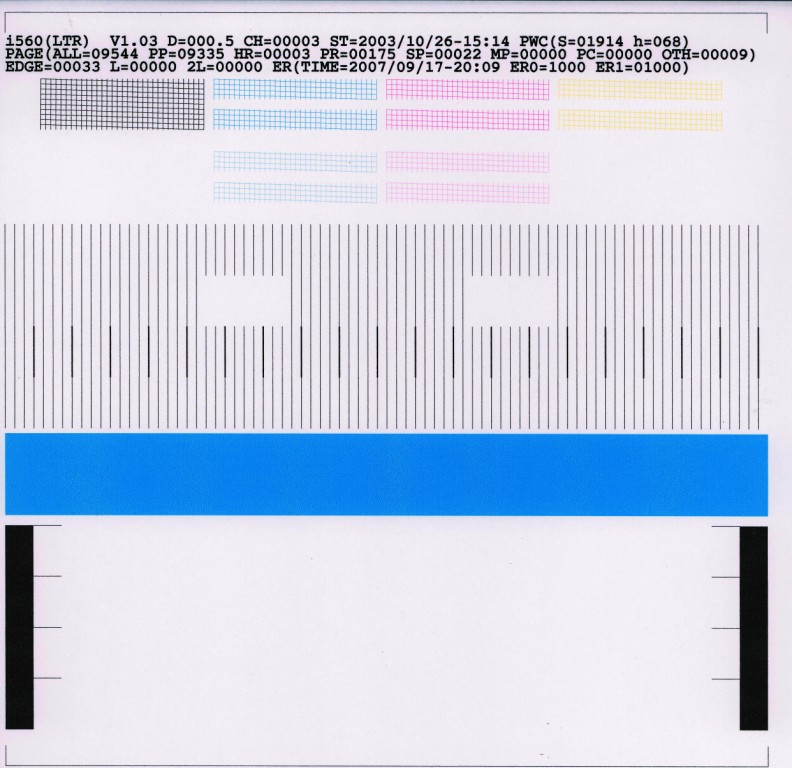

Grandad35, I've just double check the Service test pattern for the i560. If you look close that the service test print below, you will see there are 4 grid prints of Cyan, 4 for Magenta and only 2 for yellow. The specification say that there are 4 banks of Cyan (4 x 128=512), 4 for Magenta, and only 2 for yellow (128 x 2=256). Two banks of each color are for the large ink drops, which I think is 5pl, and 2 banks are for the photo cyan or 2pl ink drops. If you look at the pin assignments in the Service Manual, the pins are labeled;
Pin 3 -Cyan even column nozzle data signal
Pin 9 -Cyan 2pl odd column nozzle data signal
pin 21 - Cyan 2pl even column nozzle data signal
pin 31- Cyan odd column nozzle data signal
And then there is the printhead power signals that control firing.
Color heater drive voltage
Color GND heater drive voltage
Color Nozzle heater enable (odd/even -odd block)
Color Nozzle heater enable (odd/even - even block)
To control the data, a clock and data line pass data to the printhead which does the decode down to individual nozzles. The printhead is just a large semiconductor substrate with all kinds of transistors and diode matrix integrated together with the actual nozzles, which are also just part of the semiconductor substrate.
The bad news for me is that I now have two printer that both need a new printhead. UGGGHHHH.
It is clear from the above control signals that the only way to disable 1/2 of one bank is via the decode matrix that is built right into the printhead. In the pictures that you have been working on, you can see standard integrated decode logic in either diode or transistor matrix. Therefore I conclude the failure is in the printhead. The eeprom has nothing to do with printing. It just collects and stores data like, Head changes, temperature, etc.
If we could prove exactly which data signal controls which bank of nozzles it would be easy to help others when we see a print symptom of a missing bank or even both banks of a given color. Like I said earlier, it should be easy now with the exact pin list, to run a test by blocking one pin at a time and observe the print test. The Service test print shows the results. I conclude that each one of those Cyan or Magenta grid patterns is controlled by one pin on the head. Two are 5 pl, and two are 2pl, and I will bet the top one is "0" and will be the EVEN grid. The next one will be "1" and it will be the ODD grid. Engineers always start the numbering at "0". The bottom two are clearly the 2pl nozzles.
The height of a color bar in the nozzle test is exactly the same height of the grid in the Service Test. If you look close at the service test, the grid is 4 horizontal lines and if you count the number of vertical lines it is 32, and 4 x 32 = 128 nozzles. Each grid has tested all 128 nozzles in one bank. This makes my point earlier about how important the Service test print is. The nozzles check print combined with the data from the Service test print can provide the answer probably 85% of the time.

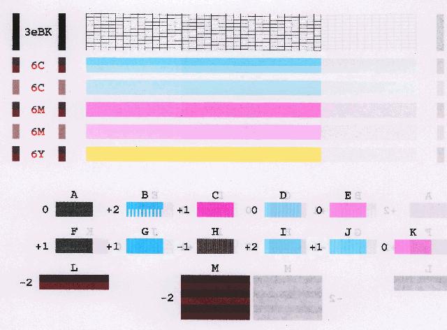

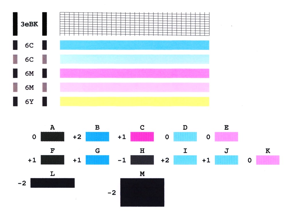

Grandad35,... You're not going to believe this,... and I guess we have to start all over thinking about what is a bad printhead. Somehow this printhead has come back to life. It is not only back, it is one of the cleanist set of tests I've seen except for a brand new printhead, in a new printer. That is saying quite a bit. I've included both the nozzle check and the Service test print of the results to show you the success. I could not believe it when I ran the first test,.. I almost fell off my chair. How I did it is described below. Here is the nozzle check pattern.
I have scanned the test print and enhanced the colors and the contrast so it is much more visible, so all the colors are much richer and vivid. As you can see, there is no problem what so ever with the Cyan nozzle check or any other nozzle. I also did an Head alignment and it was very good. No spaces anywhere, and the black bar test which comes after the head alignment was the best test I've seen in a long time. The is really not black as it is an alignment test of all the colors done at one time, so it is a combination of all the nozzles to product black with out any streaks. Fantastic. Here is the Service test print to show you that all nozzles of every color are printing just fine.
From the Service test pattern you can see for yourself, there is not one vertical or horizontal line missing in any color. All of the registration lines are in perfect condition. Not a bad job considering I just took this printer apart down to the base. removed the Purge unit to clean it and of course to remove that I had to take off the automatic document feed mechanism. Then I had to put it all back together.

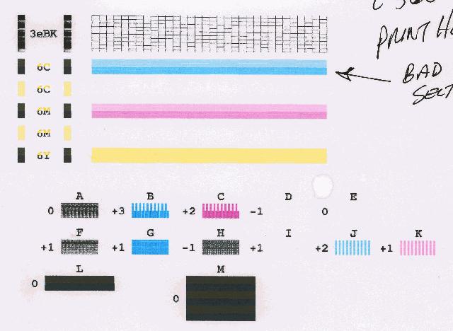

I know the information about the printhead in this last i560 has reall been confusing for me and everyone. I will try and summarize what I have observed. I can't say I have any conclusion as I am still puzzled. The problem got more confusing this morning as the I tested the i560 printhead one more time. The problem was back. The bottom half of the Cyan was faint. I tried all kinds of cleaning and Service test prints and nothing would fix it. The picture of the test are shown next.
So I took out the head and did my best cleaning process and let the head soak in Windex all day. Then I got another printhead that I knew was partially bad but at least I knew what was wrong with it. I installed it, did a deep cleaning and printed the nozzle check. It was not great so I did a couple more cleanings and got no improvement. Here is the nozzle check of that printhead.
What I noticed is that this printhead fails in the opposite way as the first head. This is very important, as one of the possibilities of the initial failure was faulty drive circuits coming from the logic board and cables and carriage asm. What this head proves is that all of that circuitry is working fine or else this head could not have printed those pattern. While I had concluded the problem with the first head was in the head, I could not prove it. I believe this test proves the problem was with the initial head.
Now after cleaning the 1st head all day long, re-installing it, priming it, it now test perfect again. So does this prove the problem all along was some kind of clog that each and every time caused a perfect symetrical failure of only one group of 128 nozzles. This is one side of one bank of nozzles. So is it a clog, or is it just and intermitant electrical connection on the back of the printhead. Those gold contact can show signs of wear if you look very close at them with a 5x magnification. The movable contact in the carriage seems to be OK, since a second head could mate with it and have no problem.

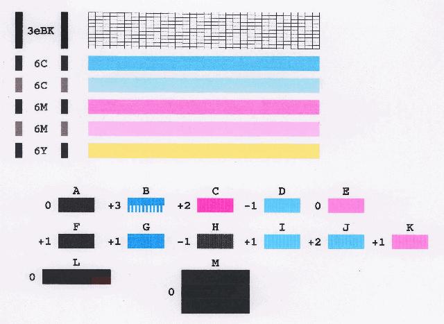

To add one more point of confusion, while I was in the process of doing cleaning cycles of the 1st head in the printer, I printed the following nozzle check. Here is the picture from that print.
You will notice that all the color bars printed correctly. The top and bottom of the Cyan, Magenta are fine. However, look at the test print under "B". You will see the bottom is only half printed. Also, look at the bottom right corner of the "L" print. It is missing some of the color. Each one of the letter test patterns from "A" to "M" use a different combination of color nozzles. For example, the top left section of "3eBK" is printed only with the BCI-3e Blk ink cart. The "6C" and "6M" bars are black made up of all three colors as is the "M" pattern. The "6C" by the Photo Cyan bar is supposed to be light gray bars as it is my by using Photo Cyan + Magenta + Yellow.
