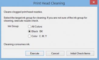

Gday All. My Pro9500 is now going to E-waste & I have to go back to using my Pro 9000 mk2. It seems the black is the only colour needing a clean out & I was wondering if there's a way to just clean out that one channel without upsetting the the other colours as the nozzle check on them looks good.
I have tubing which which fits over the head intakes so should I just fill that tube on the black channel?
I found a cleaning solvent mix on the net which is 10 parts dist water, 2 parts Iso pro, & 1 part ammonia. or is the Pharmacists solution of 3% PG glycol, 20% Iso pro, dist water the best way?

Now don’t go in blindly and make matters worse, let the printer do the cleaning because it can do it better.
The first thing to do wound be to replace the black cart with a known good one, then let the printer do a normal head clean, followed by a nozzle check, if that was not successful then run one deep clean and follow that again with a nozzle check.
You can then compared both nozzle prints to see if there were any improvements, if yes then let the printer sit and don’t print anymore nozzle checks, (Return to normal printing) if no improvement then try flooding the purge pads with window cleaner and then run another normal cleaning cycle.
Wait 15 minutes and then try another nozzle check, you can save some ink by only cleaning one side of the print head (1), and cross your fingers that you get a 100% good nozzle print.. this time, otherwise you know what the dreadful outcome will be….:th

I think the method recommended by The Hat is the one I would try. Start with a new Black cartridge to rule out the most simple fix. Flush and refill a used cartridge is an alternative, but how do you know that cartridge doesn't have issues. Then proceed to the rest of the recommendations.
Unfortunately your printer cannot clean just the Black nozzles. From your User Manual:
You will burn through more than Black ink, so have full ink in all cartridges for the task ahead.

Thanks The Hat & Stratman:) I bought a new oem Canon black cart & then did a deep clean & a nozzle check & it looks just the same to me. I let the printer sit for quite a while & did another nozzle check which also looks the same.
Do you think I should just nuke the black channel with Pharmacists solution with a tube full of solution?
