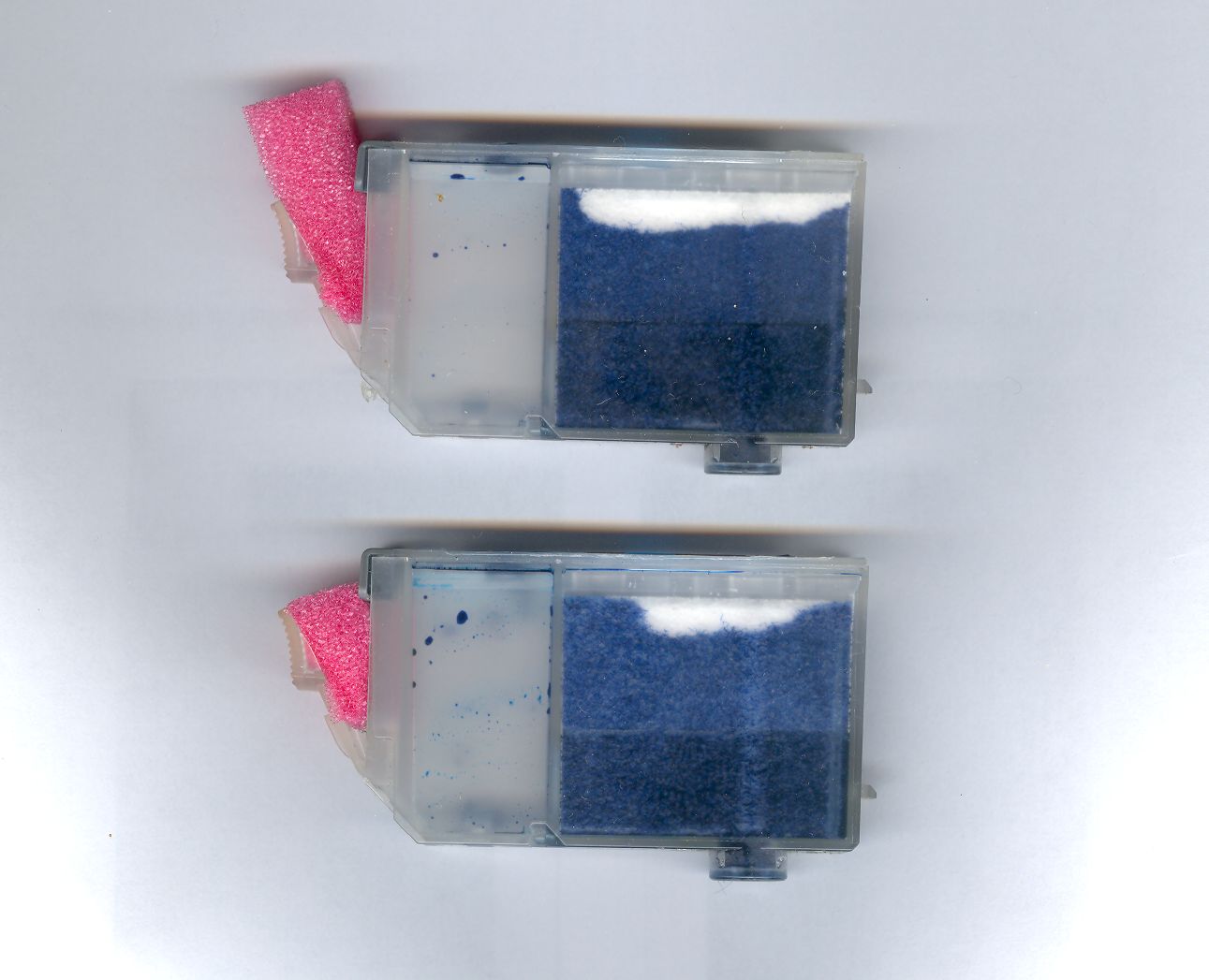

Here's a summary of what I think is going on. Much of this, but perhaps not all, is obvious or repeats what has already been written, but it's useful for me, at least. In the last section I speculate a bit on filling methods. Thanks to ghwellsjr for helpful comments on this post.

Static Pressures Within the Cartridge
Consider a cartridge with the ink chamber filled, but no sponge in the sponge chamber. The ink chamber is closed, except for a small opening at the bottom, between the chambers. The sponge chamber has a vent at the top, so it is open to the atmosphere. The level of ink in the sponge chamber will be at or above the top of the opening between chambers. If ink is removed from the sponge chamber, the level will drop until it reaches the same level as the opening. Then, as more ink is removed, ink will run between the chambers to keep the ink at the same level, and air will flow into the ink chamber to replace the ink that was removed. Generally, ink would run or seep out of any hole below the ink level, unless it's prevented by a sponge or other barrier.
Sponges
If a sponge is now placed in the sponge chamber, it will soak up ink. The sponge may contain some air, especially toward the top, and the proportion of ink in the sponge will usually be greater toward the bottom. Can the sponge prevent leaking from the cartridge, below the ink level? Generally, yes. Each pore of the sponge has a meniscus, with an associated surface tension. Because of gravity, the pressure is higher at the lowest point than at the ink level. Nevertheless, the higher pressure should not be sufficient to overcome surface tension unless the sponge is sufficiently oversaturated. However, if the sponge is pulled away and is not in contact with the opening, ink could drip.
There are one or two kinds of sponge, plus the hard filter at the bottom. The upper sponge is relatively coarse. It drains and fills easily, and can pass air easily. It may hold more ink than the bottom sponge. The lower sponge is finer, with smaller pores, so surface tension is higher and it holds ink more tightly. Nevertheless, the upper sponge is still sufficiently tight to prevent leakage from the vent during transport or storage, unless it is overfilled.
Air passages
There are some spaces within the cartridge. Some (especially Canon) sponges have an air space at the top, near the vent, with spacers to hold the sponges down. Oddly, the space is much larger than would be necessary to allow air to pass. In HP564 cartridges the sponge is in direct contact with the vent, as shown in the picture below (green arrow). (In the picture the exposed vent has been covered again with Scotch magic tape.) Both Canon and HP cartridges have one or two wide grooves, extending from the air vent down the side to the bottom. (EDIT: In Canon cartridges the groove extends from the bottom almost to the top of the upper sponge.) This ensures atmospheric pressure all the way to the bottom. In Canon cartridges (I don't know whether HP has these) there are recessed grooves in the wall that separates the chambers. The grooves extend from the bottom to a level just below the top of the lower sponge. These presumably allow air to pass from the vent into the reservoir. Although the air passes through the upper sponge and part of the lower sponge, it can bypass the most saturated lower part of the lower sponge.

I have never observed any grooves in a Canon cartridge that go all the way from top to bottom. Could you point out where you see these in one of the pictures?
ThrillaMozilla said:
In some cartridges (Canon?--not know whether HP has these) there are recessed grooves in the wall that separates the chambers. The grooves extend to a level just below the top of the sponge. These presumably allow air to pass from the vent into the reservoir. Although the air passes through the upper sponge and part of the lower sponge, it can bypass the most saturated lower part of the lower sponge..
This is misleading. The recessed grooves only go half way up the dividing wall in a Canon cartridge. So it ends just below the top of the lower sponge. This isn't clear in your description.

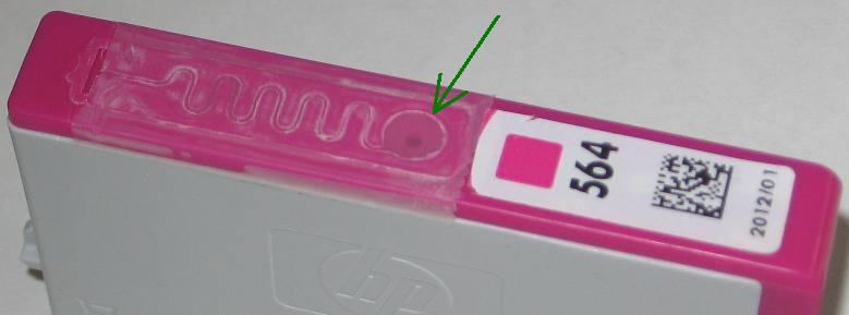

[url]http://www.nifty-stuff.com/forum/uploads/thumbs/7413_inkcartridgeventarrow.jpg[/url] (Click to enlarge)
I don't think pressures in the cartridge are especially critical. The cartridges can be stored in any position without leaking (vent up, vent down, on end, etc.), and they are supposed to work immediately regardless of storage position.
