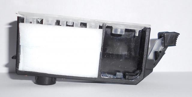

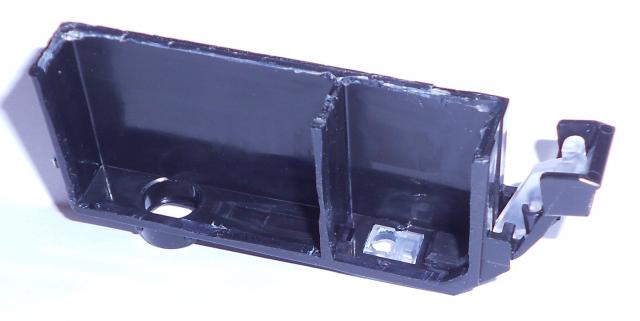

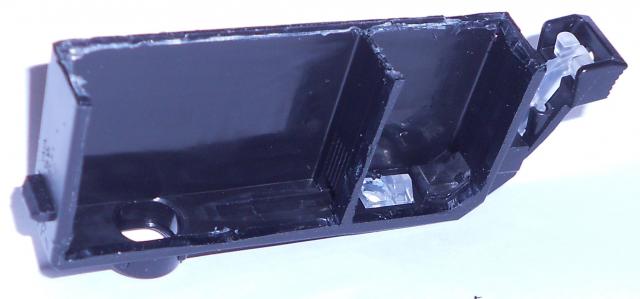

Peter, I took some pictures of the opened CLI-526:
<-- click to enlarge
Disregard the hole near the prism, I tried bottom refilling.
5,278
5,185
Thanks for the pictures. As you said in a previous post, the inner works of the cartridge are very similar to those of the CLI-x21, this confirms that the weight of the cartridges also are very similar or exactly the same.
Also thank you for the tip in this post: http://www.nifty-stuff.com/forum/viewtopic.php?pid=62653#p62653 . I will give that method a try to see if that is easier than watching the prism/window at the bottom when doing a German method refill.
