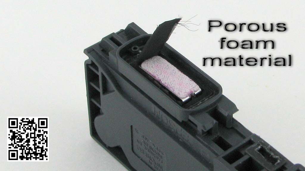

So i gather from both your findings/investigations that as a home print user and not a commercial re-filler/seller that the dribble refill method will never be an issue for me, even if this air valve thingie triggers and lets in air?
To be honest I've probably over thought the hurdles having had some quiet time to think things through a bit more so it's certainly looking like we have another refillers dream... :)

There are ARCs and there are ARCs. Some will all the time and some won't after Epson's firmware is done with them.
Websnail, I'm confused why on one hand you'd agree that the intake of air on the Epson cart would allow ink to fall down to the bottom and then turn around and indicate that such an issue does not present itself on the PGI-9. Does this not contradict the same notion? Now I present to you the bladder bag cartridges from Wide formats and even the the Epson 3880 and Pro 1. Now take a look at those and you have to wonder why it was not necessary to have the outlet of the tank/cartridge at the bottom level. If you can explain that, then you might be able to come up a justification to your idea. Maybe you've forgotten that air is not supposed to be inside the PGI-9. If it has some, it is not supposed to be there. With an airless PGI-9 ink is trapped in the folds and creases.

Agree with websnail... I have the Initial setup carts that came with the printer with some octoinkjet ARC's on them and they seem to hold the same amount of ink as miklings XL carts did.
If i could refill them It was easy :p
There is a thread a little while back saying that they were now offering a chip re setter for the carts (excluding the setup carts)

So if I get myself a couple of these standard 26 carts I would be able to pull them apart and see what makes them tick,
I hate to think I was wasting my time if the XLs were somehow different.
If I find anything new and interesting in there then Ill come back with the news and see what you guys think,
