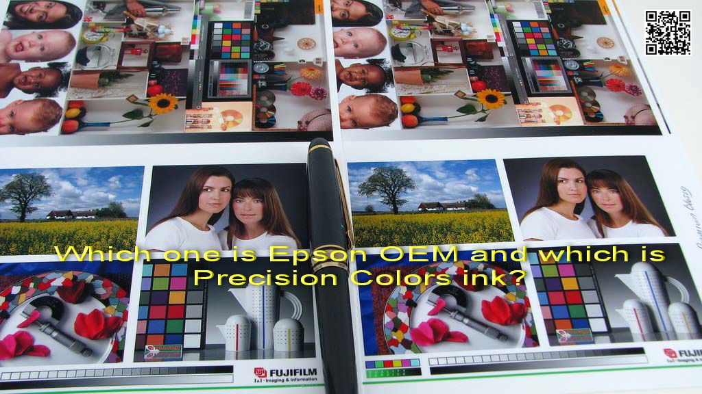

I spent quite some time to get really good output from this printer because I think it deserves it. It is easily what many want for a home printer. Very small, wireless, scanner, dual trays, Cd printing, duplex printing, high quality photos, permanent text output, EASY refilling, self maintaining cartridges. All you need is a set of inks and a few electronic chips. Nothing else! except faith.
I spent quite some time exceeding the output quality of all currently available third party inks for the Claria series that I know of. The inks are created from Image Specialists stock but the formulas are exclusive to me because I created the colors. The results show in the photos.
NO CUSTOM ICC PROFILES used!

You have just saved me the price of getting three of these cartridges to experiment with.
All your pictures are excellent and very well detailed Mike especially the one with the hole in the top of the cartridge,
and for anyone contemplating drilling a hole WELL DONT it wont work on these cartridges.
The one on the right looks to be OEM, why. :hu
Because of the white highlight and shaded areas I reckon look to be a tad brighter but I wouldnt complain about that.
Great job Mike.:thumbsup
