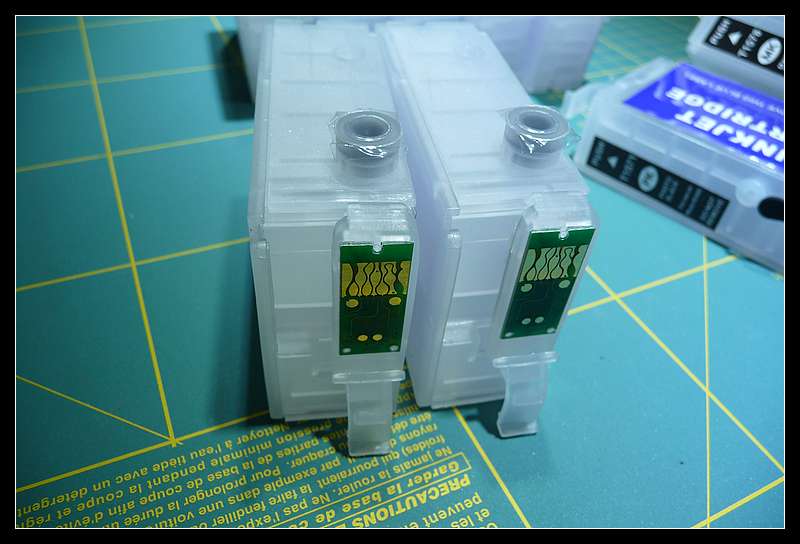

Have a close look at these cartridges. They seem to be similar to the ones Mikling showed to us.
The chips on the cartridges are powered by a small cell battery and can be reset by short circuiting the two small copper notches.
To refill the cartridges one has to remove the white silicone plug. The coloured plug with the flap should stay in place during the refill and priming stage, but must be removed when it has been installed in your printer:

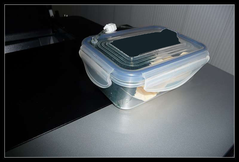

After installing the cartridges a purge cycle is triggered by the printer, so have a look at the ink waste tank. The amount poured into the tank is considerable (about 15 mls based on the increase in weight) and shows the importance to install a waste ink tank.
