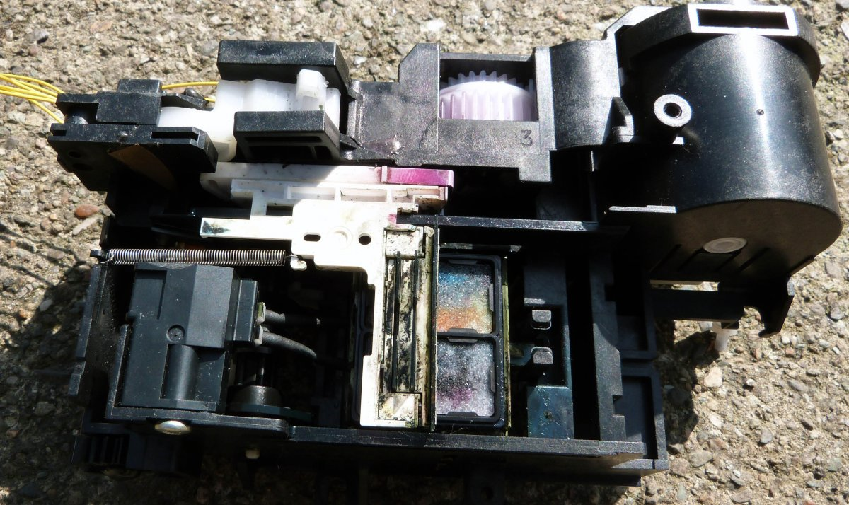

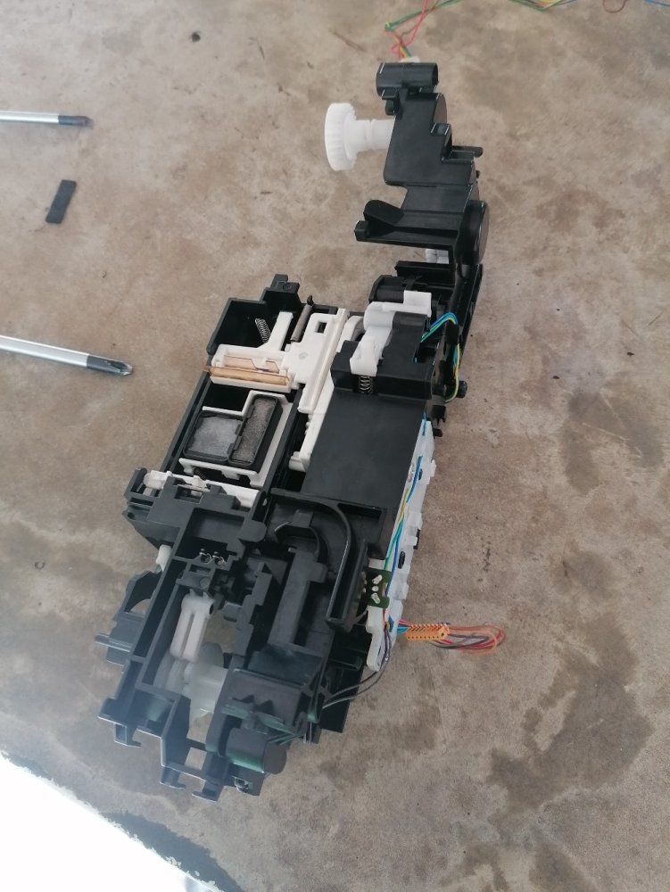

Amazing... What a mess!!
16,171
9,125

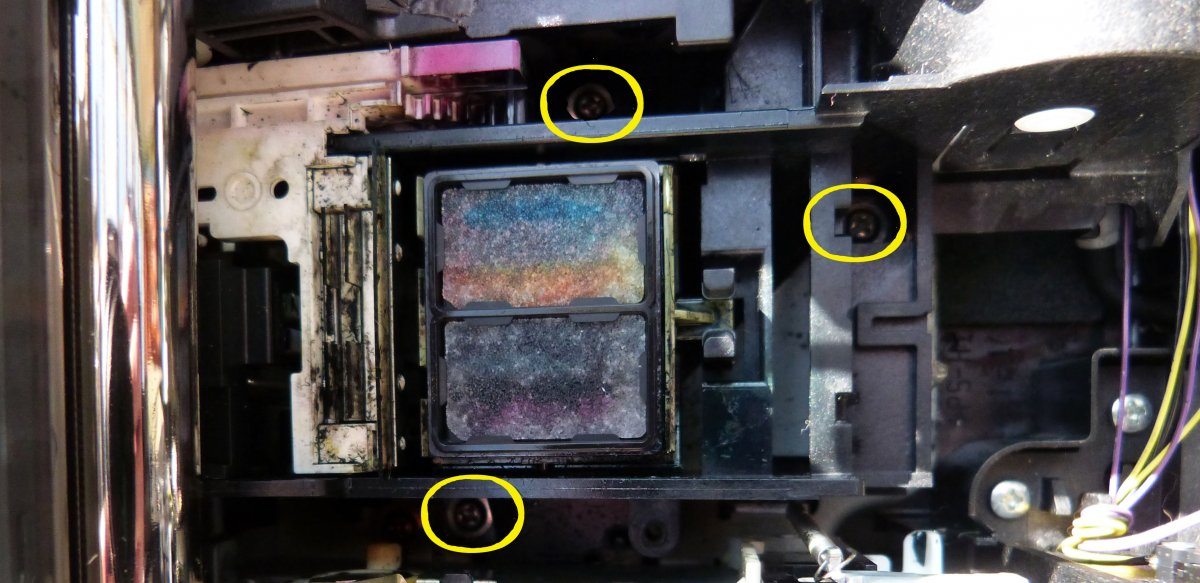

I totaly took the Purge Unit out of the Printer and dissassambled to clean it manualy, pieces by pieces.
For such a small printer that’s a mighty big purge unit, the complete Pro 9500 purge unit was tiny compared, and only needed 3 screws to remove.
Great photos and well done..
