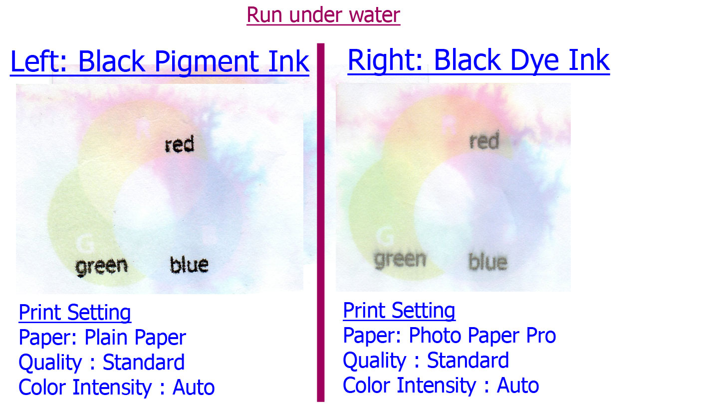

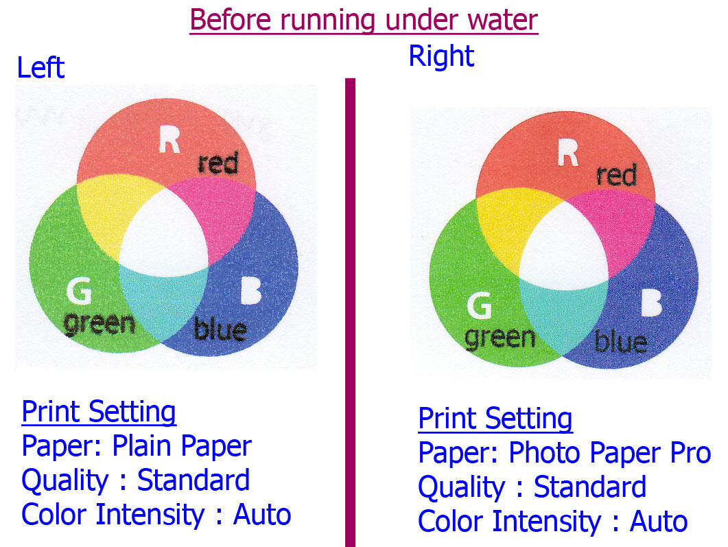

Hi My Canon printer uses these cartridges canon CLI-8C(blue), CLI-Y(Yellow), CLI-8M(Magenta), CLI-8BK & PGI-5BK. For the above pictures, I was printing using default setting, Plain paper, Standard Print Quality, Auto Color/Intensite and the rest of other setting remains default.
Thanks for correcting me that these text in the pictures are actually being printed using CLI-8 Dye-Based Color instead of pigment black ink. So I guessed it's the black dye ink that i should explore of changing since it bleeds badly when it printed over colored background.
Hi stratman, I just need to correct this again. I was right that my 3rd picture at post #18 where I run the picture under water (printed using plain paper setting) were really black pigment ink despite that color is printed at the sametime. According to my manual, when plain paper is selected as the Media Type, black pigment ink is used instead. I think if you look at your service manual for IP4200, the Print mode chart also indicated as such.
Anyway, I did further water test to ascertain that 3rd picture at post #18 was really using black pigment ink. You will notice that from the below picture (fig 2) that black text from the left picture did not fade/"disappear" so much as black text from the right picture. The black on the left at fig 2 below is still quite dark black just like my 3rd picture at post #18.
Fig 1 Before running under water
Fig 2 After running under water
However a point to note for those reading is that this current test (at this post) does not suggest that ink was the main reason for my bleeding black text over colored dye background or the text smears after running across with a highlighter. As stratman & Tin Ho had point out there could be other reasons such as paper/ink/highlighter which I need to experiment to ascertain where the problem lies. Or I could just change print setting to see if there is any improvement with the bleeding issue. Irregardless whether black dye or pigment, my black text just bleeds (just that my black pigment text bleeds more over colored dye background).
Here, I am just correcting my comment at post #23 where I assumed that the 3rd picture from post #18 was using CLI-8 black dye based after reading stratman post #20.

lin:
I didn't understand why you ran water over your prints before. Whether or not it was your intention to test if pigment or dye-based black was used for text in a color graphic, you have given emperical data showing that pigment ink appears to be is used. A simple and smart test. Thank you for this knowledge.
I have an MP830 printer. It may be that our printers select pigment black for the same but not all situations. It may be that my understanding of Canon's explanation is wrong. Would you please give the link to the graphic you used in your test? I would like to try it as well with OEM Canon inks.
I obtained the list of how the types of black ink are used from Canon's website (and echoed on several other websites) as my manual does not contain any data about how the inks are used. I've found only one reference applicable to our discusion as a "Note" and without any further clarification:
1) P. 137, Keeping the Best Printing Results: Note - If the printed area is traced with a highlight pen or paint-stick or stained with water or sweat, the ink may blur depending on the paper.

stratman said:
lin:

lin said:
Hi stratman, I saw this thread ( http://www.nifty-stuff.com/forum/viewtopic.php?id=2054 ), post #8. I thought you were using Canon IP4200. As such, I was referring to the 'Print mode' page of the Service Manual for this printer and not the 'Canon User Guide manual'.
Here are the requested pictures
1. Big Picture: http://www.nifty-stuff.com/forum/uploads/2740_inktestbig400.jpg
2. Small Picture: http://www.nifty-stuff.com/forum/uploads/2740_inktestsmall160.jpg
Ahhh, the Service Manual. I do not have that for my MP830.
Thank you for the links to the graphics. Earlier today I did my own water torture test. I had printed a mixed color graphic and text duplex page a few weeks ago, so the ink is well dried. Some may recognize the topic! I ran tap water over one half the page, let it dry and then scanned both sides of the page.
The scanned images are contained in a 1MB PDF file at http://rapidshare.com/files/81111331/Water_Fastness_Pigment_Ink_Test.pdf.
Results: The text is PIGMENTED ink with very little to essentially no bleeding on the side turned up for reading BUT a lot of bleeding can be seen of the pimented ink from the backside of the page. The situation is the same when you turn over the page. How strange!
Of course, the dye-based CMY color CLI-8 ink bleeds. streaks, seeps, etc.
Paper used was Hammermill Ultra Premium Inkjet, 24 lb., 96 Brightness, Item #16601-1, Acid Free, Made In USA. Nice paper, especially when on sale.(There is a remote possibility the paper was Xerox Premium Multipurpose, 24 lb., 96 Brightness, Item # 428437, Acid Free, Made In USA. Good results in my Fax, Laser and Inkjet.)
All ink was OEM Canon.
Printer is Canon MP830.
Conclusion: More corroborative evidence that Canon's recent chipped printers use Pigment Black for black text even when there is color on the same plain paper page.
