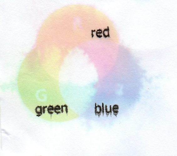

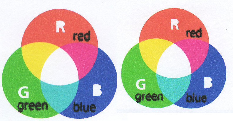

My 3rd party refilled black pigment kind of bleeds badly when it's overlay with colored dye ink on normal, ordinary A4 plain paper. However, my Original Canon Black Pigment ink does not have the same problem on the same paper & same setting which I tested for the refilled 3rd party black pigment ink.
These are my findings for my 3rd party black pigment ink for PGI-5BK cartridge which I did couple days ago.

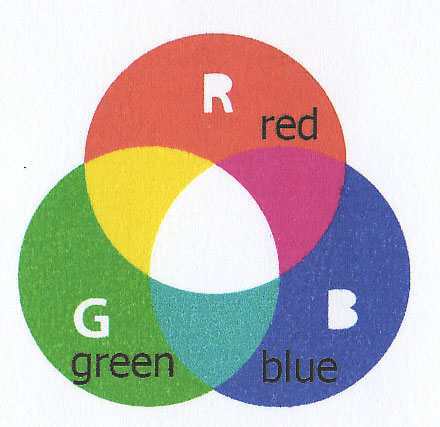

Original Canon Black pigment ink (PGI-5BK)
3rd party Black Pigment Ink refilled into Canon PGI-5BK OEM cartridge
In case anyone here wondering that it's dye-black ink (CLI-8BK) and not pigment black ink which the printer had used, I placed the paper under running tap water to show that it's really black pigment ink. You will notice that all my 3rd party colored dye-inks all run/ 'disappeared' since they are dye-based, while my 3rd party black pigment ink doesn't run/'disappeared' much.
On normal, ordinary A4 plain paper (non-coated inkjet paper)

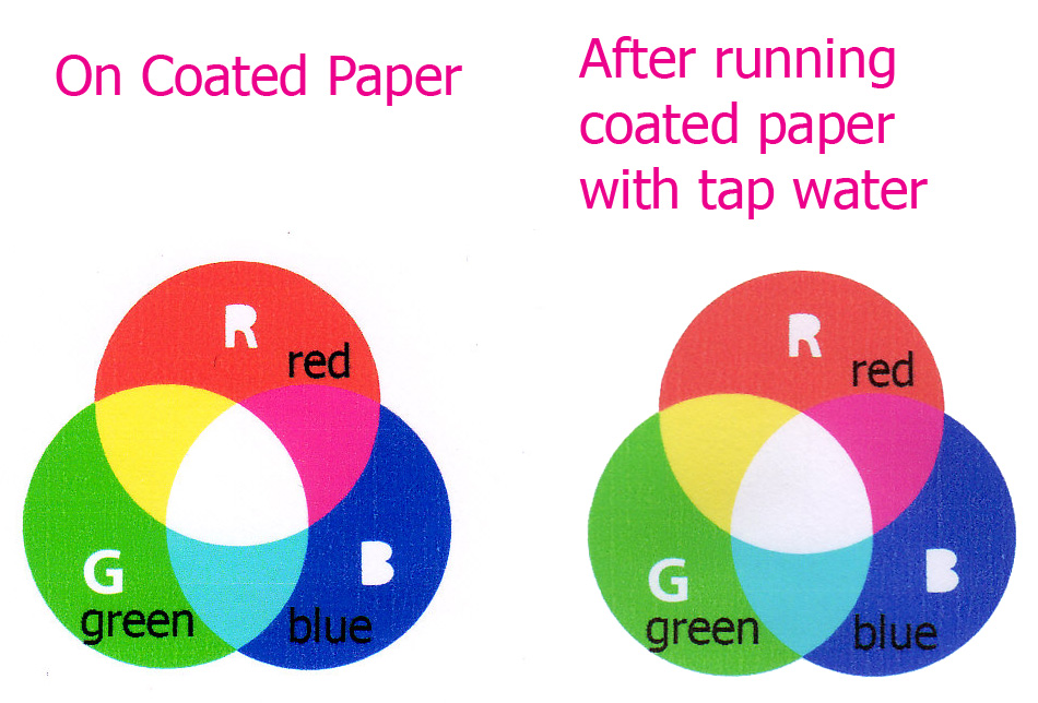

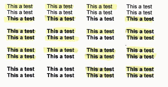

On inkjet coated ("waterproof") paper, just like my 3rd party refilled colored dye ink, the 3rd party black pigment ink adhered much better to the paper and didn't bleeds badly, the text actually appeared quite satisfactory even though when overlay with colored background. However the black pigment ink on this coated paper failed slightly at the highlighter test. You will see that it smeared slightly when you go over the text (evidently more so on bold black text) with a highlighter and the highlighter tip also picked up the black pigment ink. My original canon pigment ink does not have these problem of smudging badly or picking up the pigment ink onto the highlighter.
On inkjet coated paper

* on Dec 27, 2007: Refer to my post #23. Sorry, it seems like the text over colored dye background in the above pictures were printed using black dye ink and not black pigment ink as advice by stratman. So the result above now seems irrevelent to this thread since it's about pigment black ink.
* on Jan 07, 2008 : Refer to my post #47. Realised that my pictures here, the black text printed using 3rd party ink were indeed using Pigment Black Ink since my 'Paper Media Type Option' selected during printing is 'Plain Paper'.

"My 3rd party refilled black pigment kind of bleeds badly when it's overlay with colored dye ink on normal, ordinary A4 plain paper."
Unless you are printing color only then refeeding the page back in to do just text, I thought Canon would use dye-based black ink when "overlay" printing onto the color images you have as your example.
Your discussion of pure pigment versus mixed pigment and dye for black ink leads me to suspect the specific manufacturer/supplier of your ink. For instance, Hobbicolors has stated in correspondence with me that the mixed ink will smear when highlited and you should use the pure pigment only black ink instead.
Hobbicolor ink is excellent ink, but you need to choose the PGI-5 ink that fits your needs best. It can be a little confusing because the pure pigment is referred to as "PIGMENT black" while the mixed pigment and dye-based ink is called "pigmentED black". Identification alphanumerics or name on the bottle should help you to determine which ink you have. A call or email to the merchant that sold you the ink might resolve the issue quickly too.
